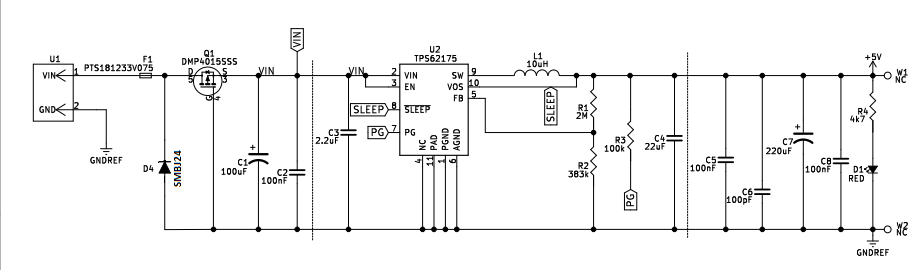

I used tps62175 Step-Down Converter to make the DC-DC conversion on my board, from 24V to 5V. It works, schematic:
Now I faced with device certification. I failed En 61000-4-5 test for Class A (R=2 ohm and signal shape 8/20 us). Actually, I passed +500V impulse. On -500V impulse device failed, tps62175 blow up. I suppose that high negative voltage appears at tps62175 inputs.
I used unidirectional TVS diode SMBJ24. Does bidirectional diode resolve my problem?

    I don't have any measured results. On the image below you can see that input pins are damaged, pin 2 and 3:
    I suppose that my diode, SMBJ24, stopped to work while -500V was applied. During this period current can go up to 250A which is too much for this diode. And as result -500V appeared on tps62175 input. Do you agree?
    Yes, I think you're right. Did you observe that the diode was damaged during the test?
    SMBJ series is limited to 600W. Did you try a comparable diode from the SMCJ (1500W) or SMDJ (3000W) series?
    We would also recommend to try a Schottky diode in parallel to the SMxJ diode (same direction). The Schottky diode would react quicker and help clamp the voltage during the -500V pulse.

    Meanwhile, I was in lab and device passed the surge test. Bidirectional SMDJ diode resolves my problem.
