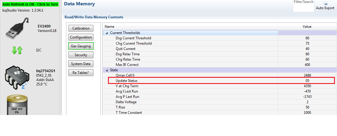

BQ27542-G1: After successful completion of Learning cycle Update status is 05 and not able to export Data Memory file
Part Number: BQ27542-G1
Other Parts Discussed in Thread: BQSTUDIO, , GPCRA0
I have successfully completed the Learning cycle for 2600 mAh battery.
But in Data Memory "Update Status = 05" only. According to document it suppose to be 06.
And i am not able to export the Data Memory File.
Please find the attached images and help me.

  • Hi Basavaraju.
    Can You issue run one more discharge ccyle , i.e charge, rest and discharge to see if the update status will get to 06?
    thanks

  • Yes, the gauge will retain the data memory values. Can you attach the gg file you extracted after your test and the gg file you started with so i see what your set your paramters to and see if the resistance tables updated.
    The reason why update status tends to be stuck in 05 is likely that the rupdis or Rdis ( not sure what it is on this guage) is getting set. That means the gauge is likely calculating a negative resistance value which is usually due to a mismatch of the chem id and the cell voltage profile or use of too high discharge current. What discharge current did you use? C/7? I would recommend trying out a different chem id that came up as a close match for your cell.. max dod error with the gpc chem tool has to be less than 3% to be seen as a close match.

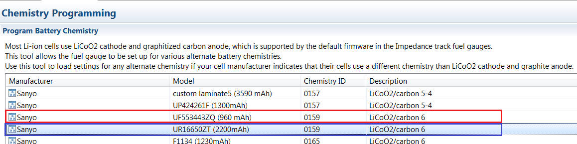

  • Hi Onyx,
    As you suggested i did one more battery charging cycle and uploaded log to GPC tool.
    This time GPC tool report suggests Chem ID: 159.
    Best chemical ID : 159 Best chemical ID max. deviation, % : 1.68
    In bqStudio this chem id there are 3 entries as shown in attached images.
    I feel, Sanyo with 2200 mAh is better because out battery is 2600 mAh. Let me know your suggestion on this.
    I will perform a learning cycle with new Chem Id 159 and update you.
    Basavaraju
  • Hi Basavaraju,
    The chem id is the same irrespective of what battery describes them. The gauge learns the resistance. So you can use any one of them.
    thanks
    Onyx
