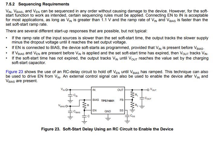

Hi, is there any requirement on the voltage ramp up/down sequence between Vbias and Vin?
Is there risk that Vin is always applied, Vbias comes later, then comes the ON signal? (Vin voltage is no larger than Vbias.)
  • Hi ,
    Vin, Ven, and Vbias can be sequenced in any order without damaging TPS74801; however, it is important to note that the sequencing order can impact the startup of the LDO.  Please refer to Section 7.5.2 Sequencing Requirements for more information.
