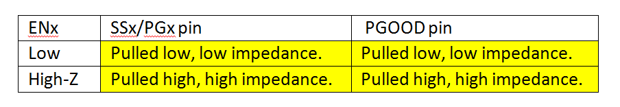

3.Please let us know pin status.
  When ENx is Low or high impedance,please let us know SSx/PGx pin and PGOOD pin status.
  Low? High impedance?

  • Zhao-san
    Thank you for your reply.
    About Question3 ,my explanation was not enough.
    Could you please fill in attached file.pin_status.xlsx
    regards,
  • Hi, sir
    Sorry, I misunderstood your question.
    As for Q3, see below screenshot.
