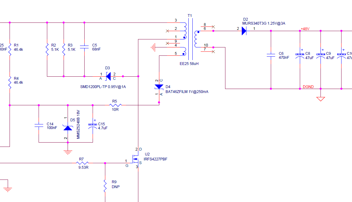

  • Hello Ulrich,
    Thanks for your response, As per the info provided by you and from the transformer manufacturer, I have chosen the following polarity please correct me if I am wrong.
    Pin No Function
    3 +input to transformer
    2 NC
    1 -input to transformer
    5 + Output of auxillary
    4 - Output of auxillary
    6 + Output of Secondary
    10 - Output of Secondary
    Please Check my Schematic and Table (Ignore the dot notation in the schematic) for correct connection of polarity. Please note Winding details are same as discussed previously.
    Vishal Kakade
  • Hello Vishal,
    Your polarity table and the dot notation in the schematic coincide.  I see no problem with it.
    When the primary FET U2 is on, there is +Vbulk at pin 3, and all of the dotted ends will have a negative voltage with respect to the other ends.  When U2 turns off and the core demagnetizes, all of the dotted ends will have positive voltage with respect to the other ends.  This is completely normal and proper for a flyback transformer.
    Good luck with your design.
    Ulrich

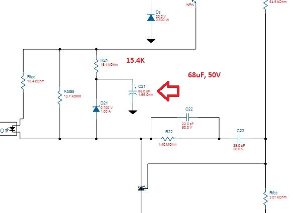

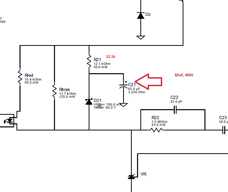

  • Hello Ulrich,
    I have simulated my design twice for same parameters and getting different results on webench why?
    Input (36-75)
    Output: 48V
    Iout= 1A.
    I have space constraints on my board.First, it is suggesting 82uF, 450V later it is showing 68uF, 50V. Why is this? What is the actual value that is required and what is the function of that capacitor?
    Vishal Kakade
  • Hello Vishal,
    The Webench design program is basically a series of design equations that are solved based on the parameters and constraints of the specific controller selected and the input parameters provided by the user. I would expect that if a design was run twice (or any number of times) with exactly the same inputs, it should produce exactly the same outputs. Since you got two different results, I guess that you somehow did not have exactly the same conditions set. Although the 36-75V input and 48V, 1A output is the same, some other subtle parameter may have been changed, such as cost, efficiency or size optimization settings or something like that.
    The purpose of that capacitor C21 (and R21 + D21) is to provide a soft-start rise of the output voltage by slowing down the rise of the TL431 cathode voltage. Like most controllers with this kind of feedback structure, full power is delivered to the output when the opto-coupler current is cut off and minimal power is delivered when the opto current is maximum. At start up, there is no output voltage and no opto current, so full power is delivered to charge up the output cap(s). As Vout increases, some current can begin to flow through Rled and Rbias, into the TL431. Since Vout is still low, its feedback keeps the TL431 off so its cathode voltage wants to stay high and keep the opto off. Soft-start cap C21 counteracts this by pulling the cathode voltage down through D21 and keeping the opto current higher so less power is delivered. The main purpose is to prevent overshoot of Vout at start-up. After start-up, R21 keeps charging C21 higher to the Q1 emitter rail voltage (~20V from Dz) so that D21 can block the C21 capacitance from affecting the TL431 transient response after start-up.
    That said, all of these parts (C21, R21, D21) are flexible, and in fact, completely optional. You may or may not need the soft-start circuit and maybe can eliminate all 3 parts. Test your prototype by removing C21 and observing the start-up response to decide if it is acceptable or not. If soft-start is needed, then the value of C21 can be adjusted to determine how “soft” the start-up should be. Lower values are quicker, so overshoot level can be tailored to minimize C21 value. R21 is just an after-start pullup, so it does not have to be 15.4K (which increases the value of C21 to keep a certain rise time), so I suggest increasing it higher to 47K or 100K or so, to help minimize C21. D21 does not need to be a Schottky diode; it can be a signal diode such as 1N4148-type (or similar, in SMD package). The voltage rating of C21 depends on how high its voltage gets. With 20V at Dz, I think a 25-V rating on C21 is sufficient.
    Webench solves a series of equations for circuit components and “chooses” physical parts to match the calculated component parameters from a database of parts loaded into it. This is a finite database, not nearly as extensive as an electronics distributor might have. For the 68uF cap, it found a 50-V part but for the 82uF cap it could only find a 450-V part in its parts list, so that is what was presented. (In either case, only 25-V is actually needed.) Some minor difference in the initial conditions between the two Webench runs caused it to recommend something higher than 68uF and the next available part that it could find was 82uF/450V. This points out that Webench is not an Artificial Intelligence but a limited program and a good degree of user judgment should be applied to scrutinize each component recommendation for understanding and sanity check. Webench can give a designer a quick short-cut to a suitable circuit solution from only a hand-full of user inputs, but it is the designer’s responsibility to optimize those results for real-world implementation. Meanwhile, TI strives to continually improve the performance of Webench, but given limited resources with increasing breadth of product lines and a bewildering variety of topological design directions, such improvements are incremental and sporadic.
    Ulrich

  • Hi Vishal
    Can you try sharing with me the design for which you saw 82 u capacitor, i created the design for this condition
    Input (36-75)
    Output: 48V
    Iout= 1A.
    Ta = 30 C
    Source - DC, and got 68 u caps, multiple times
