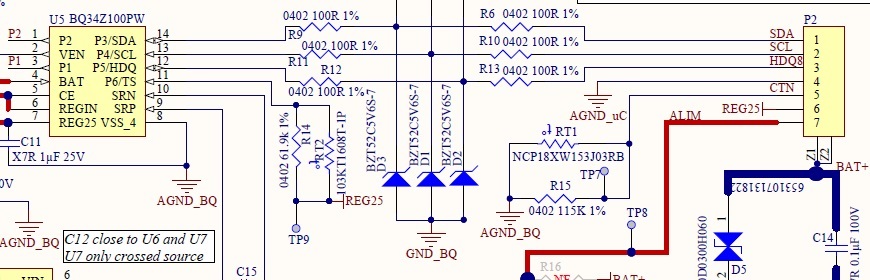

My question is about protection diode for communication pin. The document mentions a max voltage of 5.5V max.
However, Your schematic of demo board integrates diodes zener 5.6V (AZ23C5V6-7). It's normal ?? (we could think of putting diodes of smaller voltage)
Moreover, you mention a min voltage of "Vcc-0.5V". And Vcc = -0.3V to 2.75V. But there is not Vcc pin on BQ34z100-G1.
Can you explain to me Vcc please ?
  • Hi Charles-Elie,
    The supply voltage (V REGIN) of the device must be between 2.45 and 4.5 V for the device to operate. Keep the voltage between 2.7 and 4.5 V for flash writes and 2.45 to 2.7 V with no flash writes.
    Please size the diodes to your application. The clamp circuit may be replaced by your own power rail.
    In this case Vcc may refer to REG25.
    Sincerely,
    Bryan Kahler
  • Hello Bryan,
    VREGIN is always between 2.45 and 4.5V (we use TPS7A1633DRBT).
    But for your information, pull-up resistors are not integrated in our circuit. Here the schematic :
    "Please size the diodes to your application." => Our goal is to protect the communication pins of the BQ34z100 for a maximum of cases. Applications can be diverse and varied,
    If I understand correctly: do not have a zener diode under 4.5V and above 5.5V . That's why I was surprised to see 5.6V diode, and I wondered if there was any reason.
    Best regards.
    In the datasheet, in part "Absolute Maximum Ratings" - Viod (Open-drain I/O pins (SDA, SCL, HDQ, VEN)) : max voltage = 5.5V.
    And, in part 'Recommended Operating Conditions' - VIH(OD) (Input voltage, high (SDA, SCL,HDQ)) : max voltage = 6V.
    It is amazing to see an operating condition higher than the max conditions.
    It's a mistake ? What is the actual max voltage not to be exceeded? (for SDA, SCL,HDQ)
    Best regards.
  • Hi Charles-Elie,
    Thank you for the feedback. The systems team has been notified. Please stick to the Absolute Maximum Ratings Value of 5.5 V.
