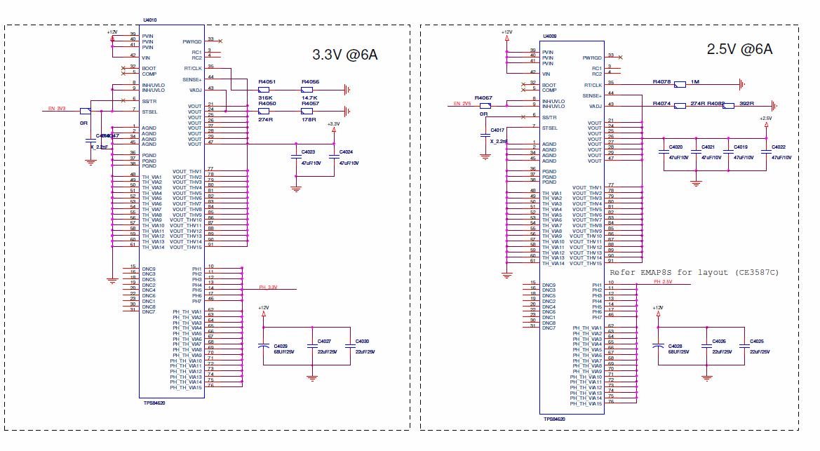

We are using TPS84620 for generating 2.5V and 3.3V and TPS62140 for generating 1.1V
Picture 1 and 2 shows the power up sequencing of 1.1V vs 2.5V and 1.1 vs 3.3V.
Issue 1: The waveform observed of 2.5V and 3.3V are not smooth as 1.1V.
