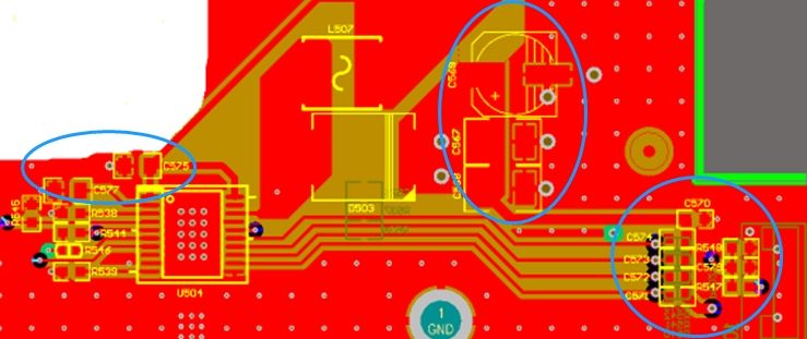

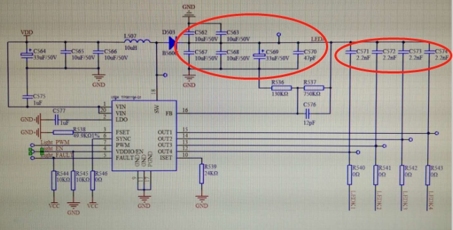

here is the SCH with layout:

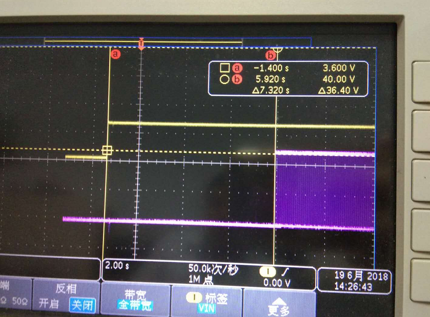

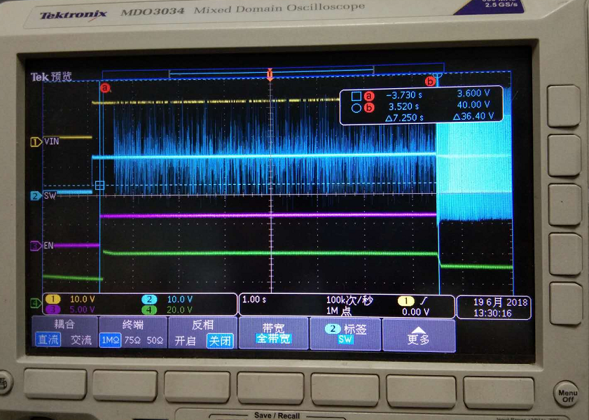

We tested the waveform of OK and Wrong:
OK:
Wrong:

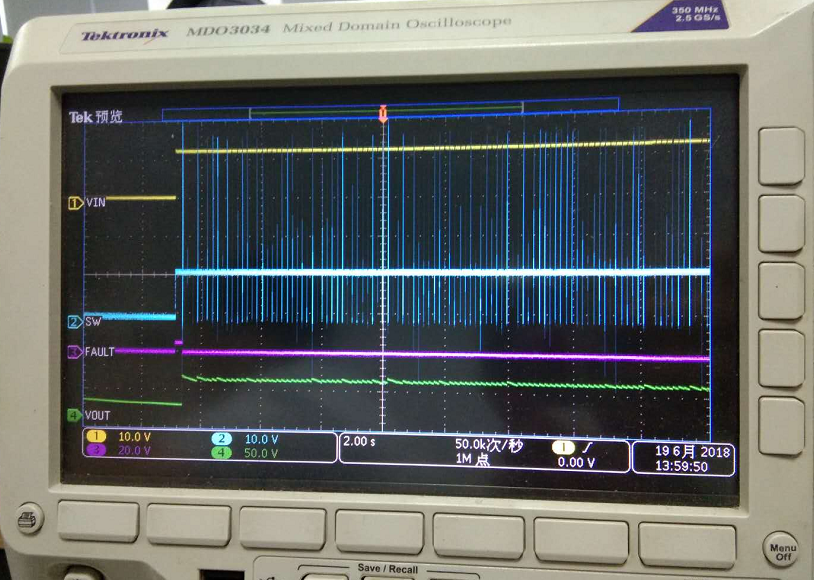

and test PWM to show the turn on timeline

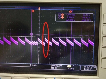

Found it may be cause by peak of SW,and continue enlarge the wavefrom of SW:
Then test the OUT1~4 of TPS61194-Q1
according to the datasheet:
Customer wonder if it is really cause by peak of VOUT,Then how to develop the SCH?There are some different Cap for this part,but still could not work well?

    From the schematic, it seems that capacitors C571-4 are connect from Boost to OUT pins which is correct, but LEDs should not be connected after capacitors in series. LEDs should be connected in parallel to these capacitors from BOOST to OUT pins. I think this could be causing LED open fault to trigger. Please let me know if this is the case.
  • hello,
    The schematic is not complete, the capacitors are paralleled to LEDs not serial. so the schematic is right. more information i will check with customer engineers.

    We reviewed the schematic and here are our comments below. There does not seem to be any major issues that could be causing the issue. If this is only seen in one device, we would recommend submitting for FA.
    1. FSET = 49.9k - Set for 1.2 MHz OK
    2. ISET = 24k - Set for 100mA OK
    2. Connect SYNC pin to VDDIO/EN pin instead of VCC rail
    3. FB network set to max 37.1V. Make sure max Vf is ~15-20% lower than this. Also, consider using T-divider network in order to reduce the feedback resistor values and keep Vout min higher than Vin max. Please see attached calculator to select proper resistor values. Use R2 = 6K and R3 = 27k will modifying R1 to yield proper max output voltage.
    0020.TPS61193-4 FB Divider Options.xlsx
    4. Recommended output capacitance for 1.2MHz full load condition is 3 x 10uF (cer). Can reduce output capacitance but ensure that phase/gain margin show good stability
