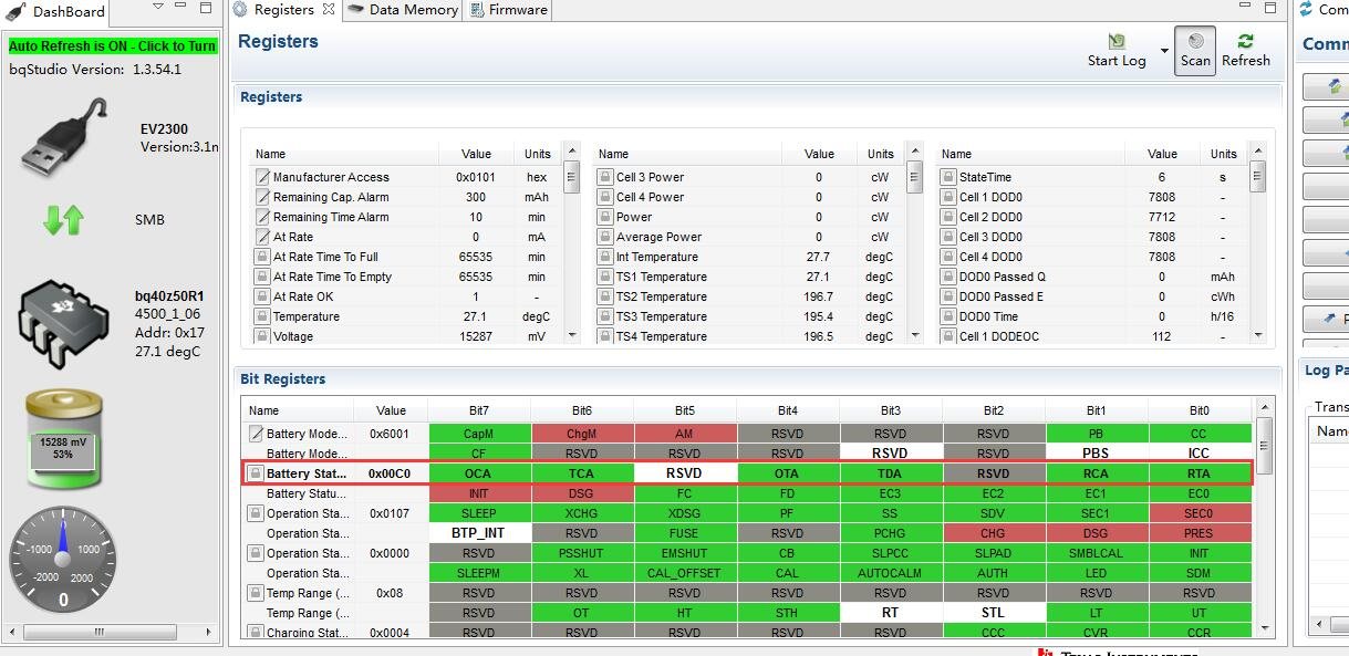

Hi,all:
I found a problem during the use of the BQ40Z50-R1:
The battery pack is connected to the power supply board and will be found to be incapable of recharging.
Unplugging the battery pack and externally connecting the constant current regulated power supply can recharge the battery pack.
The power board uses the LTC1760 to read battery information.

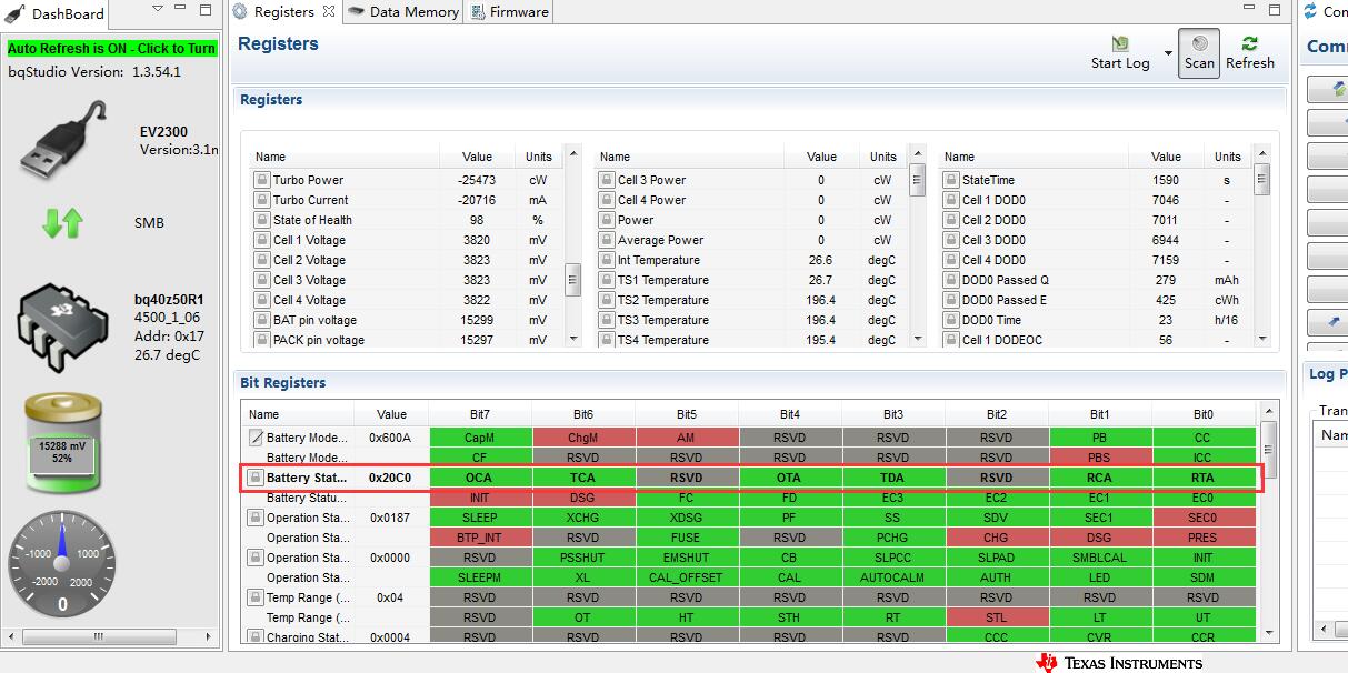

Reading the register through BQ Studio finds that there are two RSVD flags set, resulting in the power board can not be charged.
I think this is not a problem with the BQ40Z50-R1 that cannot be recharged, but why connecting the LTC1760 will cause RSVD to be set. How can this problem be avoided and solved?
The bit2 and bit5 in the figure will be written to 1 and cannot be charged
