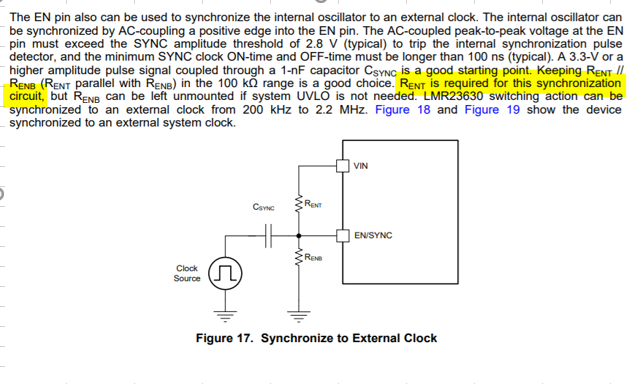

  • Hello Katelyn,
    Thank you for the clarification - it was confusing since the datasheet also showed this example for external clock sync:
    Also, since the amplitude of the AC signal must be at least 2.8V, does that mean for a 1.7V EN signal, the HI SYNC signal must be 1.7 + 2.8 = 4.5V?
    Thank you,
    LG
  • Hi LG,
    I understand your confusion. The datasheet example would be one way to connect the SYNC signal.
    The AC signal must have a peak amplitude of at least 2.8V, and it must have an average voltage (Duty Cycle x Peak Amplitude) must be greater than 1.7V.
    Please let me know if this is still unclear or if you have any additional questions.
    Katelyn Wiggenhorn

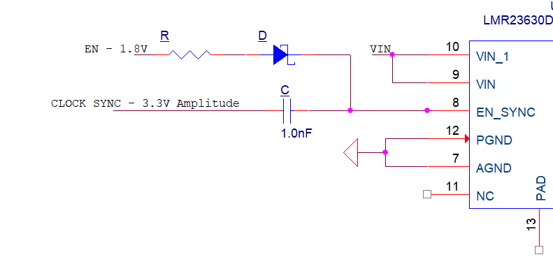

  • Hi Katelyn,
    Does that mean it would be possible to have both an AC external clock to sync the device AND an EN signal to enable and disable the device? Something like this:
    Assuming a duty cycle of 50%, the 3.3V clock alone would not have an average voltage of 1.7V - but with a 1.8V enable, would the converter turn on and be synced with the 312.kHz external clock? Or is this not an option?
    Thank you for all the help,
    LG
  • Hi Lucy,
    Yes, the configuration that you show on the schematic above should be ok. I don't think you need the diode though.
    -Arief
