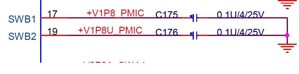

When I design TPS650940 for APL LPDDR4
Have anything I need to take care ?
Beside VTT pin can be floated and PVINVTT and VTTFB shorted to GND
Hi Kenny,
You are correct. SWB1 and SWB2 are expected to be shorted together at their output and then connected to V1P8U which is used as VDD1 input for LPDDR4.
