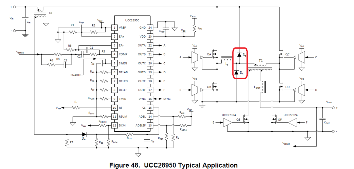

In the Detailed Design Procedure the worst case power dissipated is (Ls energy * T) -> (1/2L*i^2*f) and it says "normally they do not dissipate much power"
Does anyone have the idea of which is the possible cause of overheating of the components DB and DC, used to fix Ls potential? Which is the abnormal condition?
The circuit is without SR (unconvenient for high voltage and low level of the output current), there is a full bridge rectifier whith a passive snubber on the secondary side.
I attach the schematics, in this case diodes involved are referenced as D2 and D10 that corrisponde to DB and DC.
The part actually mounted is STTH310S, comparable to the MURS360 in the original design.

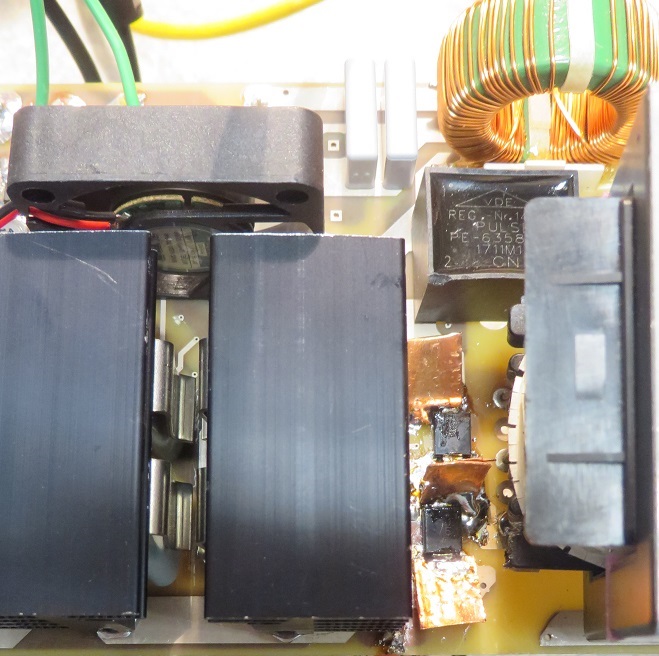

    changing the two diodes with MURS360 immediately improved the situation, giving me chanche to work on the circuit. I've also added homemade heatsink, doing so the temperature of Da and Db reaches 70°C: I think I can evaluate a standard SMD heatsink for the next prototype or to use a similar diode in TO-220 package.
    Then i could evaluate the output bridge, finding that it was causing many losses: I put other diodes and now the overall efficiency seems adequate.
    I attach the photos of the home made heatsink and the new efficiency table.

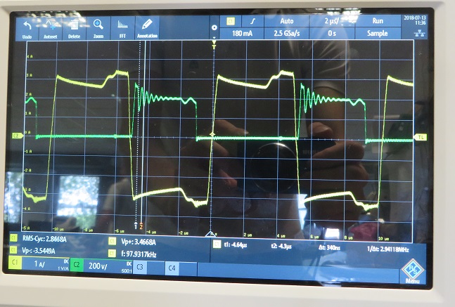

    I take the opportunity to ask: I scoped this primary waveform in jellow, which is not like the literature (the green one is the voltage across one rectifier) :
    do you have any idea about this? Maybe is it due the output snubber which stores energy?

    I'd make a few comments - first, it is clear that the diode is getting avalanched at the start of the turn off interval. This should be avoided - ideally one would reduce the amount of unclamped inductance in the diode path (short wide PCB traces) and also improve the snubber design so that the ringing is damped out more quickly than is shown here. Initially at least I would work with output diodes with a higher breakdown voltage. it also seems here that the output inductor current is discontinuous - is this what you expected at the operating conditions when the picture was taken? I think that you are correct that the current waveshape is due to the output snubbering - but I have to double check this with some colleagues.

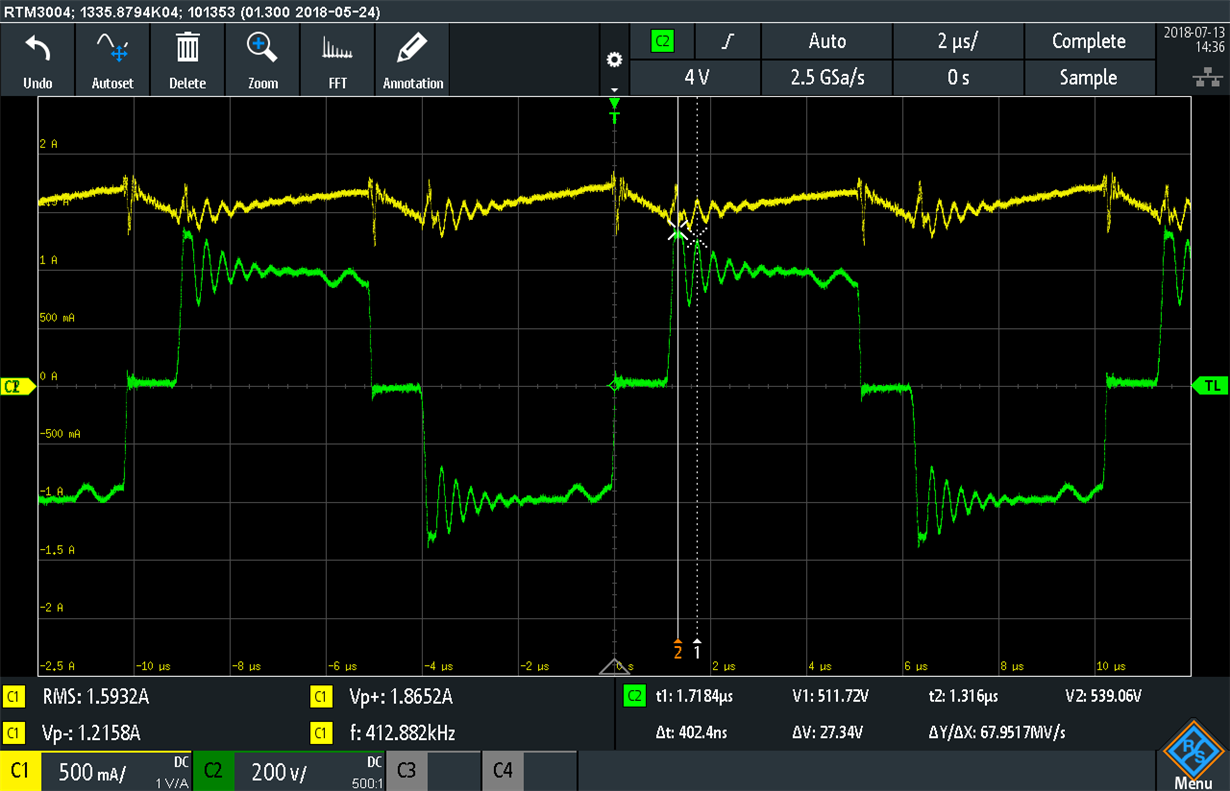

  • Mr Colin,
    I imagine that the main cause  of the overshoot  is the secondary leakage inductance: is that correct?
    I think inductor is conducting correctly, please confirm regarding the waveforms that i took at 600W out...
    Shown here:
    green = secondary voltage (differential probe 25Mhz), yellow = inductor current (1:1 probe 5Mhz)
    here:
    Green = inductor voltage, yellow inductor current, orange primary current with a 200mV/A ->This probe is only 500kHz of BW, so please consider it just as a reference (the real shape is shown in the previous reply)
    Please consider also that the frequency in the inductor is 200khz, the oscilloscope its evaluating it  wrongly probably for the spikes.
    To support the overshoot is currently mounted a 1200V ultrafast rectifier at the secondary side.
