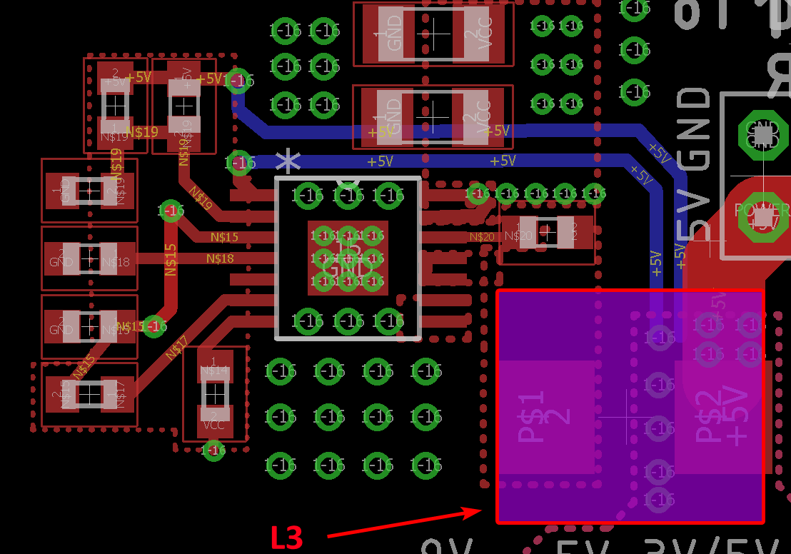

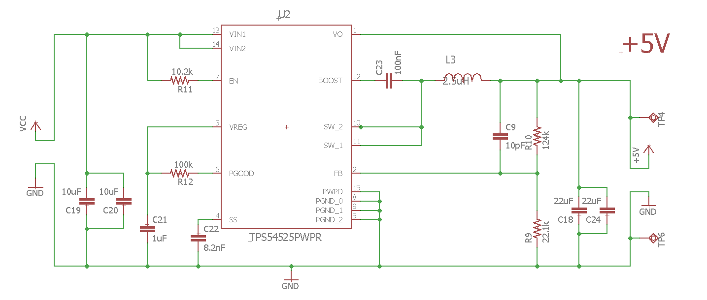

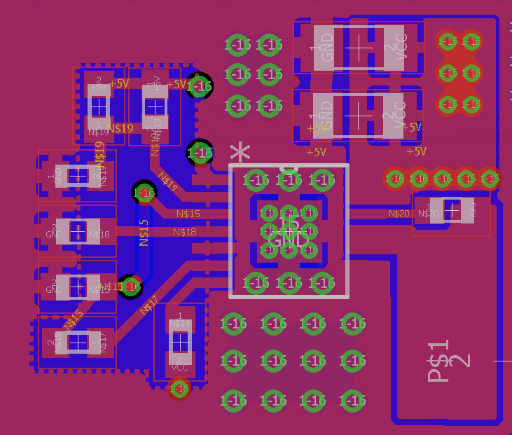

I have a design for the TPS54525 based on a WebBench design with 11-13v input and 5v 4a output.
The issue is that sometimes it will work and output the correct voltage, other times it will fail and not output any voltage.
I have tried a different chip and replaced all the other components on the board multiple times just in-case its a failed component and nothing changed, It will still fail to work a majority of the time.
I have tried it under a 2amp load and with no load.
I have another design on the same board for 3.3v output that is copied and pasted from the 5v design and that works flawlessly, it only seems to be the 5v design that is affected.
I have attached pictures of the schematic and the board below.
If anyone can spot any potential issues in the schematic or the design, or suggest some tests i should perform, that would be fantastic.
