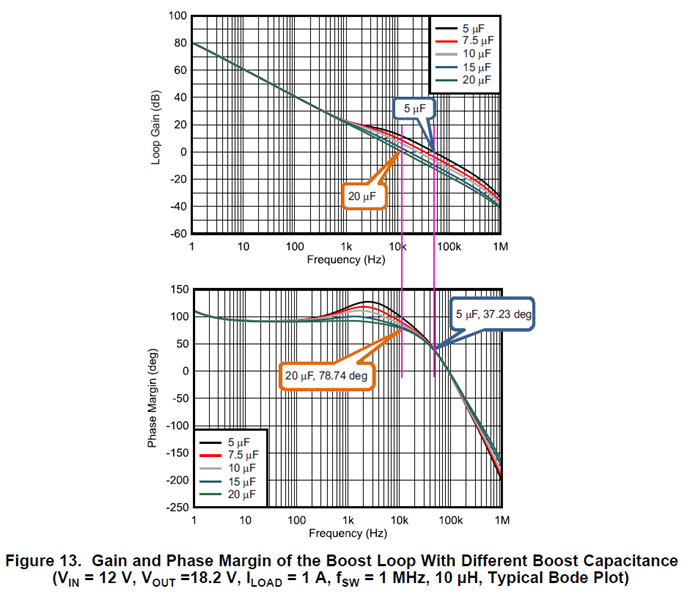

Hi Team,
We understand that the recommended minimum actual capacity of Boost Capacitance is 5uF at 10uH.
Is my understanding correct?
If no, could you please let us know the recommended value?

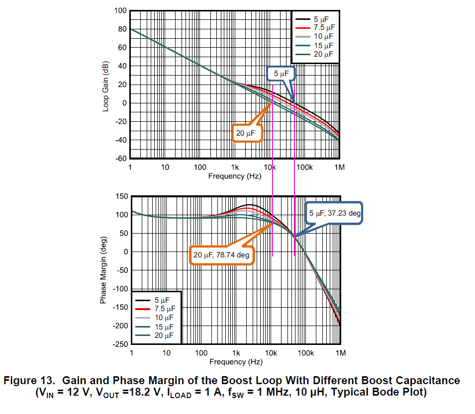

Hi Team,
