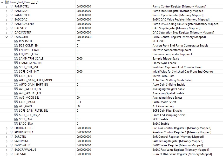

2)
But if I change the FE mode using the code:
void EADC(void)
FeCtrl1Regs.EADCCTRL.bit.EADC_MODE = 3;
That I receive such result:
As you can see, the mode was set, but all the default settings were reset.

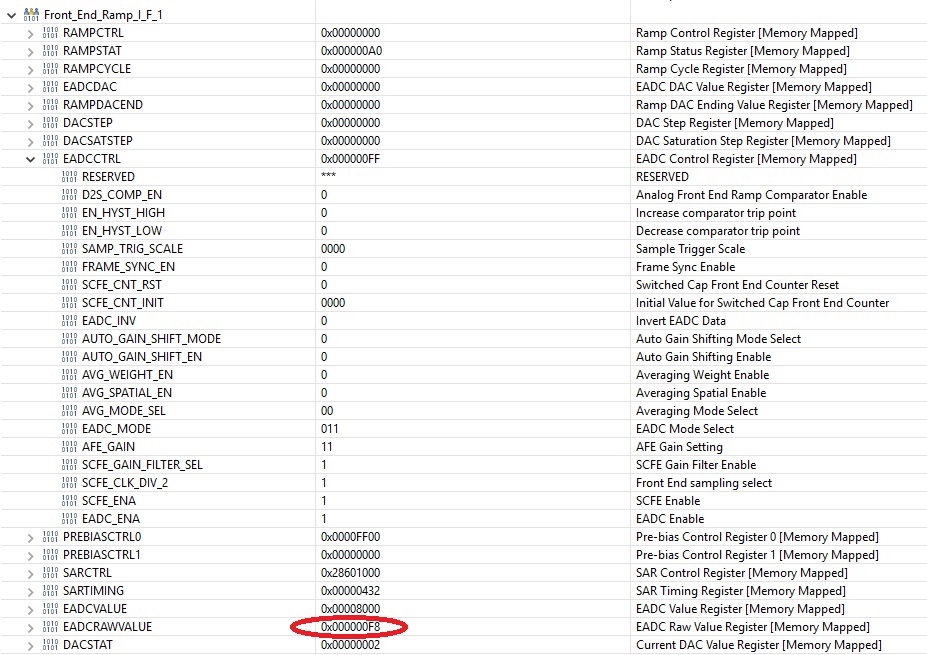

3)
If I set the standard settings myself using the program code:
void EADC(void)
FeCtrl1Regs.EADCCTRL.bit.AFE_GAIN = 3;
FeCtrl1Regs.EADCCTRL.bit.SCFE_GAIN_FILTER_SEL = 1;
FeCtrl1Regs.EADCCTRL.bit.SCFE_CLK_DIV_2 = 1;
FeCtrl1Regs.EADCCTRL.bit.SCFE_ENA = 1;
FeCtrl1Regs.SARTIMING.all = 0x432;
FeCtrl1Regs.PREBIASCTRL0.all = 0xFF00;
FeCtrl1Regs.SARCTRL.all = 0x28601000;
FeCtrl1Regs.EADCCTRL.bit.EADC_ENA = 1;
then I get the same settings as the default ones.
But the module does not work correctly, EADCRAWVALUE = 0хF8 and does not change.
This is normal if the DAC has a low value.
But the DAC automatically changes the value in SAR mode.
1000000000b
0100000000b
0010000000b
0000000001b
The voltage at the input of EAP1 is the same as in the first case.
Thank you for your help.
    An engineer is looking into this and will respond.
  • That's interesting. I know that we've gotten the SAR to work, but the people who've done it are out on vacation this week. From what I've seen before with things that work with debugger, but not with code, it's generally due to delays. I would suggest writing to the EADC mode register after a significant delay, simulating what you are doing with the debugger. Let the filter and DPWM get enabled and run for a while, and then write the 3.
