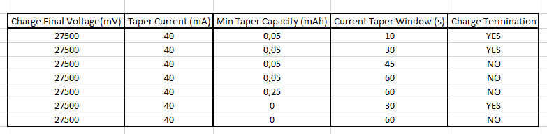

I am using a BQ34z100-g1 with an 8s2p LiFePO4 batteries.
I have been finding problems with charge termination because in some cases bq34z100-g1 is not reaching the FC condition. I attach the following image when you can see the differents tests I have done.
When Current taper window is 60s (2 taper windows would be 120s) and taper current is 40mA, I have never achieved to reach a charge termination. I have tried to reduce the min taper capacity to 0mAh but it is still impossible.
When current taper window is 60s but taper current is > 70mA, bq34z100-g1 always do a charge termination.
What can be happening with this charge terminations? is there any condition, no specified in the datasheet, to be taken into account?
