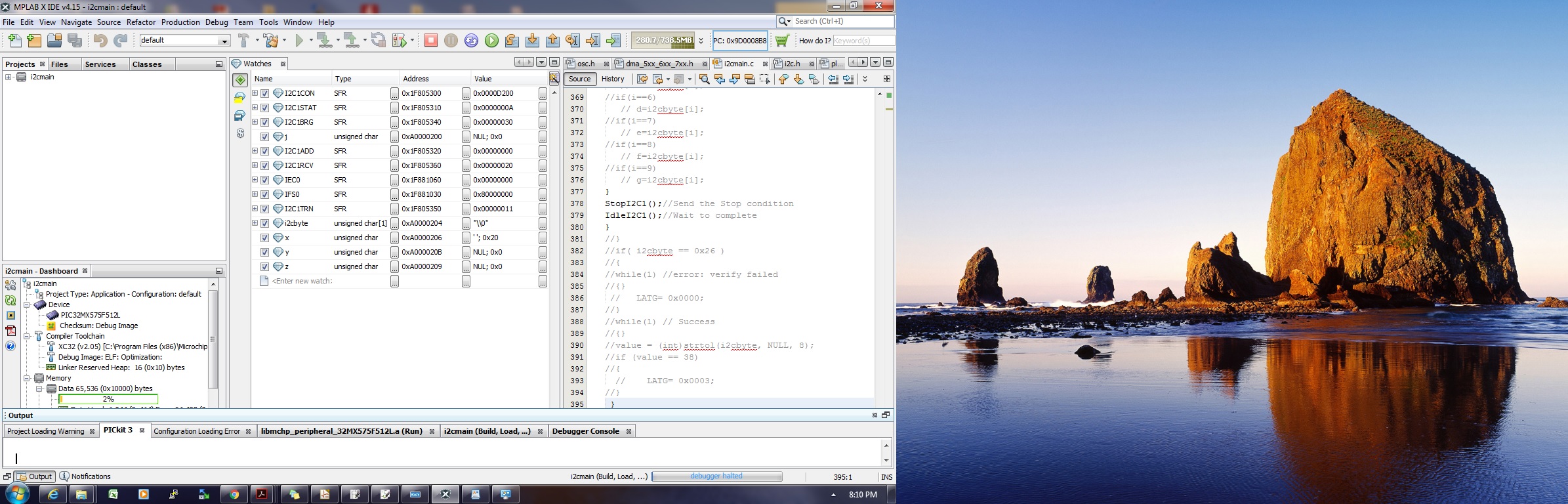

I am using PIC32mx575F512 and BQ76940 AFE for BMS design.
I have written a code to write to sys_ctrl1 register addressed at 0x00 with 0xFF.
I am unable to change the register values.

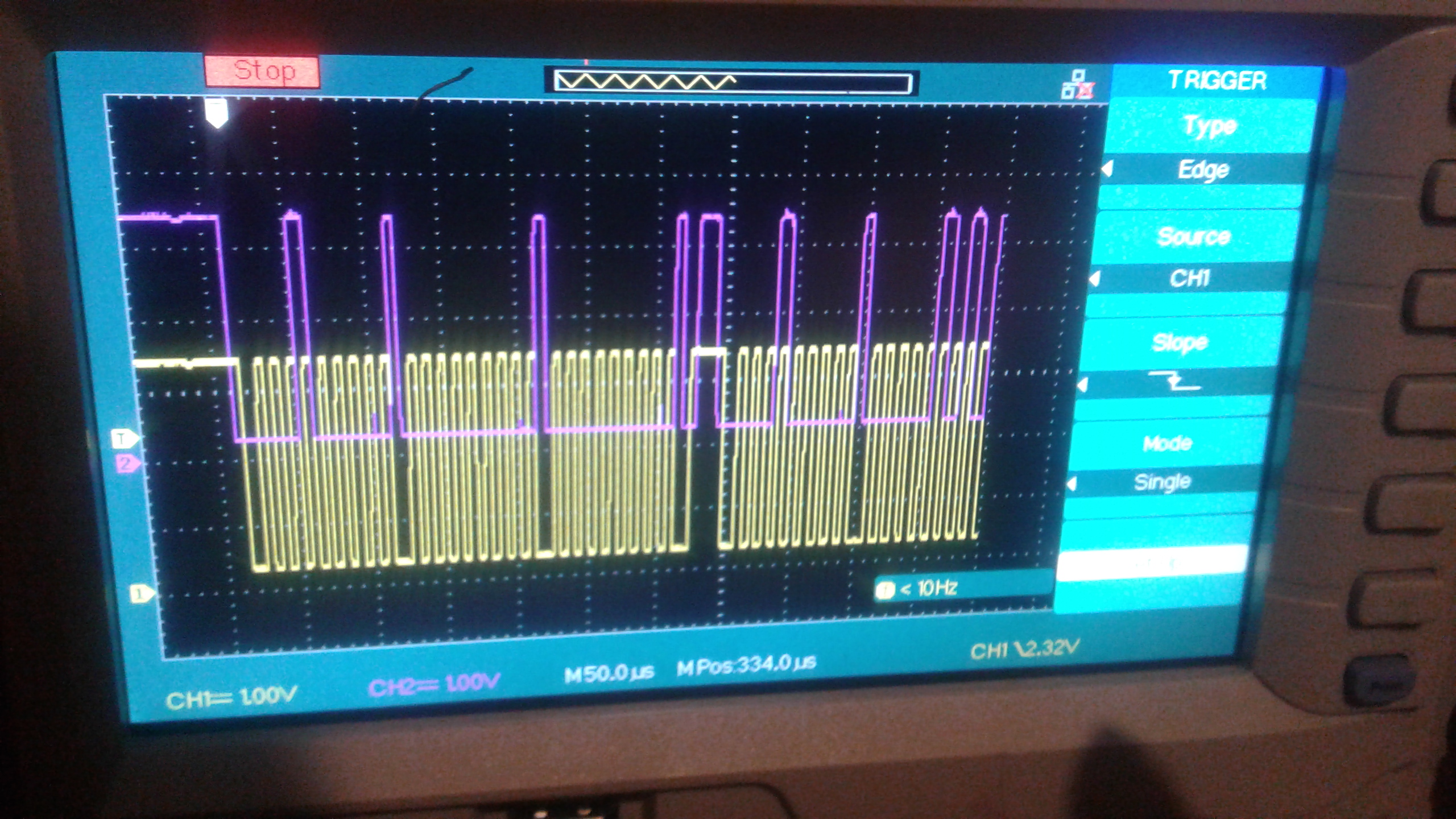

    With the CAP3 capacitor voltage 0.3V, the top group is off and the part will give an XREADY fault which will not clear. Check the power supply voltage to the BAT pin and upper cells. Be sure to follow the recommended cell connection of table 8-3 of the bq76940 data sheet. However this should not prevent register operation.
    Your first transaction looks like a write register 00 with data 00. This does not clear the status register.
    The second transaction looks like a write register 05 with unknown data since it is off the side of the screen.
    I don't recognize a problem with the waveforms. You might try a read of register 00 first to see you get data back from the part. Again if the power is off on the top group you should expect to see an XREADY fault, bit 5 or 0x20 if there are no other errors.

    3) Yes I am able to work with Registers. The scan which i posted is of different operation. I Tried writting 0xFF to SYS_STAT register and when i read back i was able to receive 0x20 which means as specified upper group is off. Can you let me know how to make this on?
    4) i am Able to receive 0x20 and there are no other errors.
