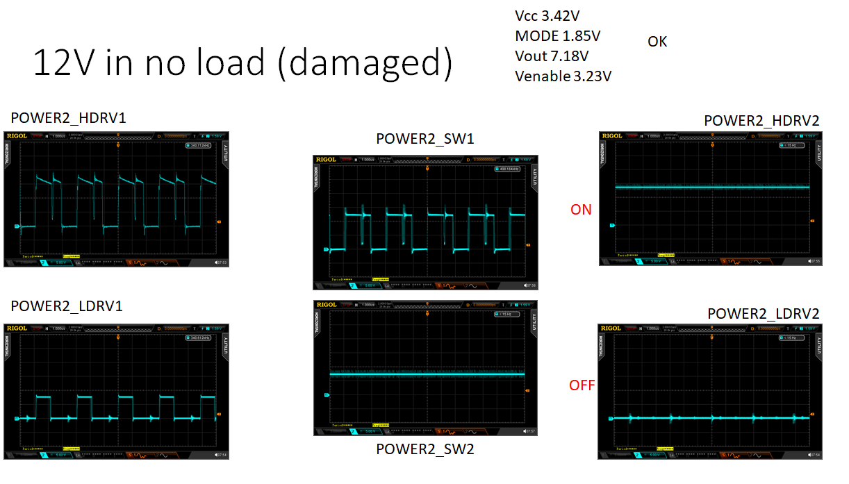

We designed a buck/boost DC-DC based on the LM5175. The input is 5V to 24V with an output of 7.2V and 10A.
Sometimes after a unexpected load, the VCC pin get 3.4V and the IC stop working once a small load is applied (~0.2A).
Some values during normal operation:
  • Vcc 7.32V
  • MODE 1.85V
  • Vout 7.18V
  • Venable 3.23V
Once the IC stop working, the new values are:
  • Vcc 3.4V
  • MODE 1.85V
  • Vout 7.18V
  • Venable 3.23V
I'm not sure what is causing the unexpected load in the circuit, neither why the IC could be damaged once a high load is present (if this is the cause).
Another situation we found during testing, was an audible sound when the power input is decreased (voltage and current). We follow suggestion about finding the source with a pencil, but was very hard to located. The level sound increase when the input power is reduced (voltage or current).
Any advice pointing to a solution is appreciated.
We are going to manufacture a second revision and would like to include any improvement to avoid these situations.
Hu Lao
  • Just to clarify, the output is 7.2V without load. Once a load is applied, the voltage decearse to almost zero. All the external components seems to be working, because once the LM 5175 is replaced, everything start working.

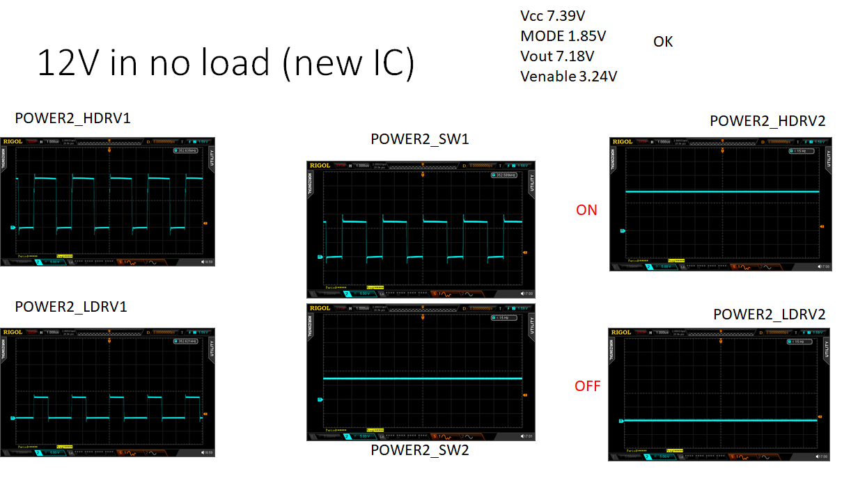

  • Hi Garrett Roecker (3456925) ,
    We update the PCBA including a schottky clamp to prevent excessive negative swing on the switch node. Refer to attached figure for results.
    We perform new testing on the board including new equipment, and we was able to use a input of 5V to 24V [with max 20A] and simulate a load up to 10A. The results was OK in all the range.
    At the end, we was able to damaged 2 of 2 IC, with a "short circuit" test. So, right now, we have a defined test condition to damaged the IC, with the symptoms mentioned previously. Knowing  this condition, may you why the IC short circuit protection is not working as expected?
  • Hi Lao,
    Can you please take some screen shots of when the device is being damaged? It would be good to monitor the buck and boost switch nodes as well as the VCC voltage. Maybe when the output is being shorted there is an over voltage on one of the pins that might be causing the damage.
    Garrett
