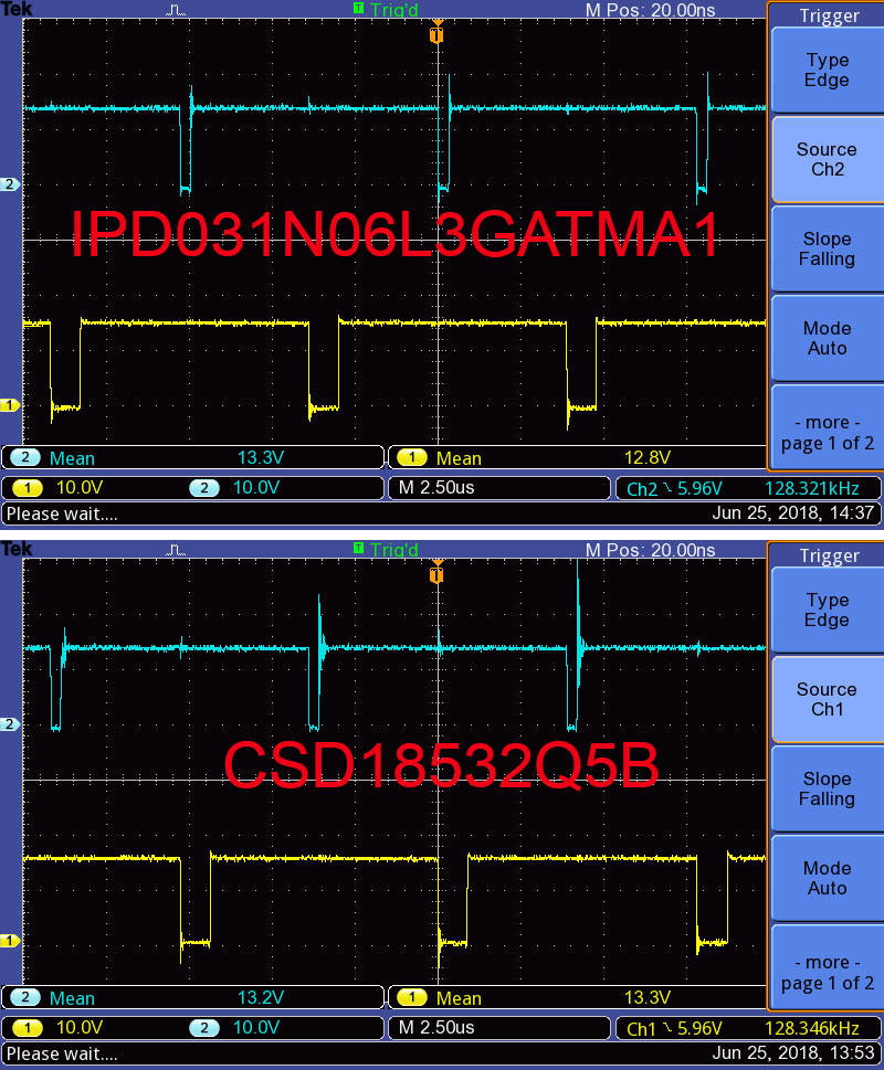

I'm developing lead battery and supercapacitor charging device based on LM5176.
9-15V VIN   …..  0-15V 9A OUT CCM - mode; DITHERING - disable; NO BIAS supply; Frequency 250 KHz.
I used IPD031N06L3GATMA1 MOSFETS in a buck and bust leg. Ciss 10 000 pF;  Qg 59 nC.
Now I install the new one in a buck leg CSD18532Q5B.  Ciss 3 900 pF;  Qg 44 nC. to reduce the capacity load to lm5176.
In a bost leg I install CSD17573Q5B.
I see large oscillations in in a buck leg after the replacement.
What can be the problem? I'm afraid, that Uds max.=30V may be overload.
Thanks!
  • Hi Andrey,
    It is important to probe the SW voltage properly having as short as ground lead as possible. This will give a more accurate reading of the peak voltage.
    When changing MOSFETs this ringing frequency and peak is going to change due to a number of parameters. One of the best ways to work around this is to add a snubber and tune it to make sure the ringing on the switch node does not exceed the MOSFET voltage. Here is an application note that covers how to tune a snubber properly.
    -Garrett
