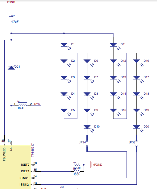

    This is K Harshavardhan. We got TPS65217CEVM (PMIC EVM).
    By giving the voltage of 5V to the AC pin of the EVM we have powered the board.
    The jumpers JP34 and JP33 are implemented.
    We are not able to sink the current to ISINK1 and ISINK2 pins.
    We have set the registers as below:
    WLEDCTRL1      00001001
                                0X09
    WLEDCTRL2      00110010
                                0X32
    But when we set the WLEDCTRL1 and make current sink enable the device got reset.
    When we monitored the voltage at cathode od D21, the voltage is dropping down.
    We have checked the LED's individually, they are working fine.
    Please support in overcoming this problem.
    Thank you in advance.
    Harsha

    I see no issues with the WLED settings you have selected, and I have been running my TPS65217CEVM with these settings for the last hour or so without issue.
    There are 2 reasons for your issue that I can think of, but they are not actually related to the LED driver:
    1. The current limit on your DC power supply is too low (connected to AC, pin 2 of J3, and a nearby GND, pin 1 of J4 for example) - if your current limit is below 300mA your DC supply may droop or turn off, causing the PMIC to reset. This is an estimate, but >300mA should be high enough without any other loads on the PMIC

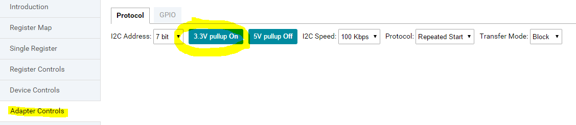

    2. There is a timing issue on PWR_EN that you are not aware of, and it appears the LED driver is causing the PMIC to reset - the PWR_EN pin must be set high within 5s or the PMIC will reset and be stuck in a Reset loop until PWR_EN is set high. Jumper JP9 must be shunted from pin 1 to pin 2 (PWR_EN shorted to V3P3) and you must ensure that V3P3 is actually being generated by the USB2ANY (you can probe R9 or the high-side of R1 or R2 to verify). In the screenshot below I can toggle V3P3 On/Off as needed. For the TPS65217CEVM, it is required that this supply is ON.

    The LED operated when we increase the limit of input current in the DC supply.
    Previously we had only 1A supply. Now we changed to 3A one.
