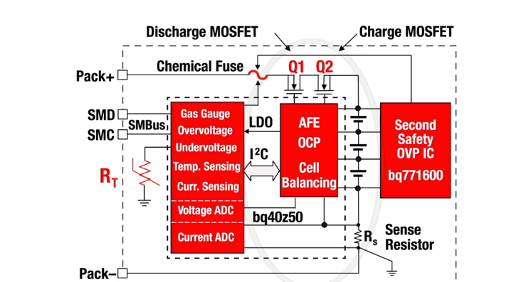

we are interested in an evaluation board similar to what is shown in the picture below. BQ25703AEVM was an option due to the PowerPath, voltage and current monitoring, but it does not include neither termination voltage when the battery is charged nor protection circuit, etc. Our battery is 2S 30Ah and the required charger input voltage must be in 4 V - 30V (although this is not that important since a previous buck-boost converter can be implemented as previous stage) so basically the question is,
is there any evaluation board (or a combination of them) which includes charger powerpath, protection with standalone termination, gas gauge and balancing?
