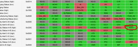

Problem: current is not very accurate, more than 3A will protect.
MOS closes the alarm bit like the following figure
I tried to set the parameters of the current in the register, which were not effective, and still showed protection when discharging 3A. Are there any related parameters to be set
How is callbration gas  available?
  • The calibration can only correct by about 25%, so if the error in current measurement is more than that, it will not be able to calibrate in bqStudio.
    Most likely the issue is that the sense resistor that you are using is not 1mOhm, and since the default configuration of the calibration settings is for 1mOhms, you may have to manually change the "CC Gain" and "Capacity Gain" in the "Calibration" section of data memory to your sense resistor value and then calibrate again and then it should work in bqStudio.
    Swami
  • Now it is certain that the discharge ASCC alarm, and the actual current is not greater than the SCC TH (2:0) /Rs (the voltage of the actual resistance at both ends and not so large voltage 4.5Mv), so it is more strange

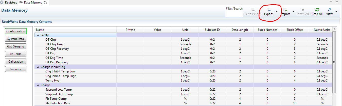

  • Please post a bqStudio log file during the test, as well as your gg file.
    Let me check why you are seeing this issue.
    Swami
  • 1、Log file in the appendix;

  • Hi Garin,
    Could you please post a log from bqStudio during the test:
    as well as your gg file:
    The R1 to R2 change spec is available at
    Swami

    2, during the charging process, LED can display electricity for a long time.
    3, through the short press button, let LED display electricity;
    4, the battery capacity is 10%, LED flicker
    Now the function of buttons and LED can not be controlled each other.
  • Unfortunately the LED and Display button functionality of the bq40z50-R2 is not customizable.
    The different modes and settings for the LED that are available are described in Section 8. ("LED Display") of the TRM for reference.
    Swami
