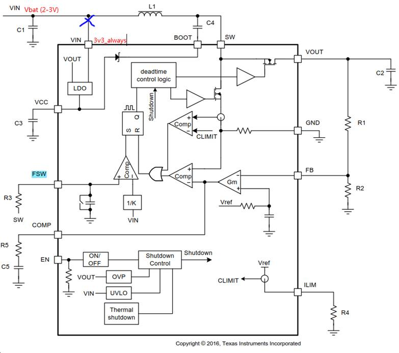

Dear sir
Our project wants to select TPS61089. Our requirement is Vin = 2-3V Vout = 6.5V Iout=1.5A.
But TPS61089 Vin minimum requirement is 2.7V. So I prepare use 3.3V to supply Vin. Vbat connects to power inductor L1.
Please help me check like this using method is OK or not.  Thanks very much.
