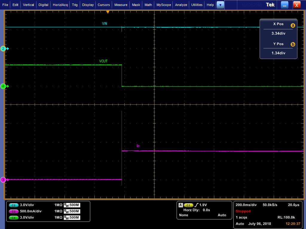

  • Hi Bala,
    Can you please share test waveform with 2A current limit case to look at. It should limit to 2A typ. Probe Vin, Vout, Iin, FLTb signal.

  • Hi Bala,
    You are correct.. The device will limit to lower currents than the set current limit value in output hot-short condition. This is because of fold-back behavior of the device when Vout is close to the ground. This should not be a concern to the application as it is limiting to lower values in fault mode.
    For soft overloads, the device regulates to the set current limit. Please let me know if you have any further questions.
    Rakesh
