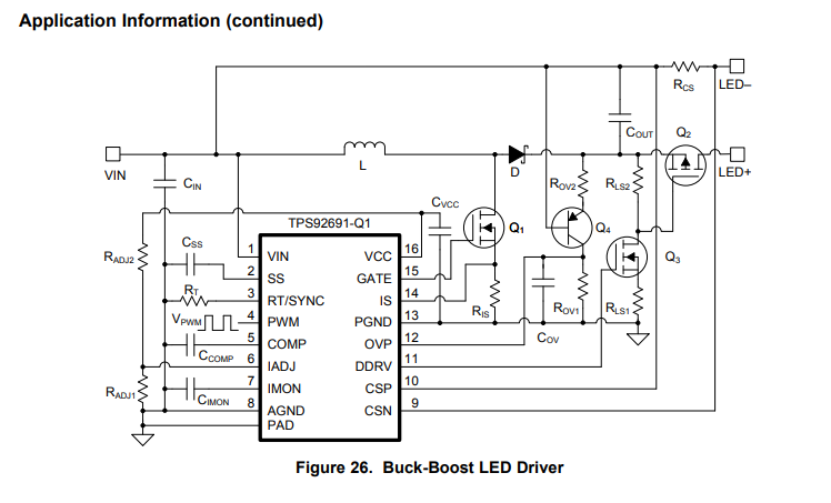

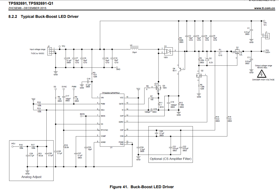

My customer is want to use LED driver for automotive application, customer want to use TPS92691-Q1 buck-boost mode. In buck-boost's OVP Q4 triode application, DATASHEET, both circuits are connected differently, Which connection is correct?
