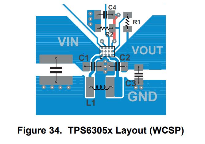

TPS63050: Layout Example Confusion
Part Number: TPS63050
The datasheet  states that C2(PFM/PWM) and B2(ILIM0) pins,in the middle of IC package, must not be left floating. These two pins seem has no connection in layout example below. Would you please help me to clarify this example ?
