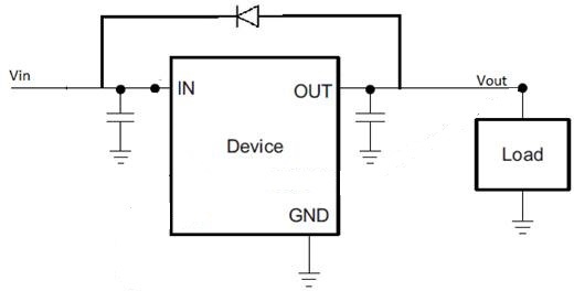

I want to use TPS7A8300 in my design. My application is Battery powered, so there will be the minimum voltage of even 2V(or Less) at Vin pin of the LDO.
Since this LDO does not have Reverse current protection, will there be any issue if I do not provide Reverse current protection externally???
One more doubt is will there be any chance of going VOUT higher than VIN in the above application?? This LDO doesn't Boost at any case right??

    You only need to add reverse current protection if Vout may exceed Vin in your application. You are correct that the LDOs do not boost the voltage; however, there are a few ways that Vout may exceed Vin in an application.
    In some multi-rail applications the output of the LDO could be unintentionally biased above its set voltage. Since most LDOs do not have a way to sink current, it is up to the LDO's load to pull the output voltage back within regulation. If Vout is biased above Vin, reverse current can flow.
    More commonly, if the input of the LDO were to collapse at a faster rate than the LDO output capacitors can be discharged, Vout would exceed Vin and reverse current can flow.

  • Hi Madhu,
    It is the capacitor value not the package size that matters.  The more capacitance on the output rail, the more energy is stored on the output that could flow backwards through the LDO if Vin were to drop below Vout.
    It is important to note that TPS7A83A does have an active pulldown on the output when EN is driven to logic low.  The active discharge will provide a safe discharge path from the output capacitors to GND if you were to disable the LDO; therefore, it is only if the output rail suddenly collapses while the LDO is still enabled that could potentially cause reverse current.  As your Vin is a battery, this case is probably unlikely in your application.
    We do not have a high current LDO with a built in reverse current protection that is not qualified to a higher grade such as automotive devices.  If you believe that reverse current could occur in your application, please consider adding a diode in between OUT and IN.  This diode will provide a robust path for reverse current should Vout exceed Vin.

  • Hi Madhu,
    You only need reverse current protection (either built into the LDO or externally provided) if Vout is expected to exceed Vin. It does not sound like your application will have this occur from the details that you have provided. As such you would not require any reverse current protection.
