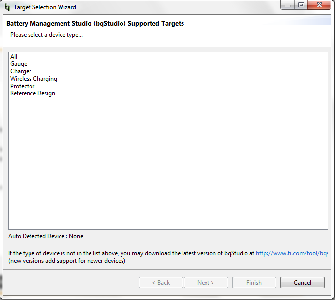

    I have run the latest firmware installer, still I have been facing the same issue. I have attached a snapshot of error message for your reference.
    Is there any other way to calibrate bq34110?
    Please suggest some point on this as soon as possible
    Viken.
  • Hi Viken,
    That is very strange - it should have auto-detected the device. Can you try the following?
    1) Download the latest version of bqStudio from ti.com. It is currently 1.3.86 and is labeled as a TEST version. This version has many updates and will soon be released as the official version.
    2) Can you take a photo of your setup? What voltage are you applying to power the EVM? Are you using the I2C output on the EV2300 and are all of the EVM jumpers in the correct position?

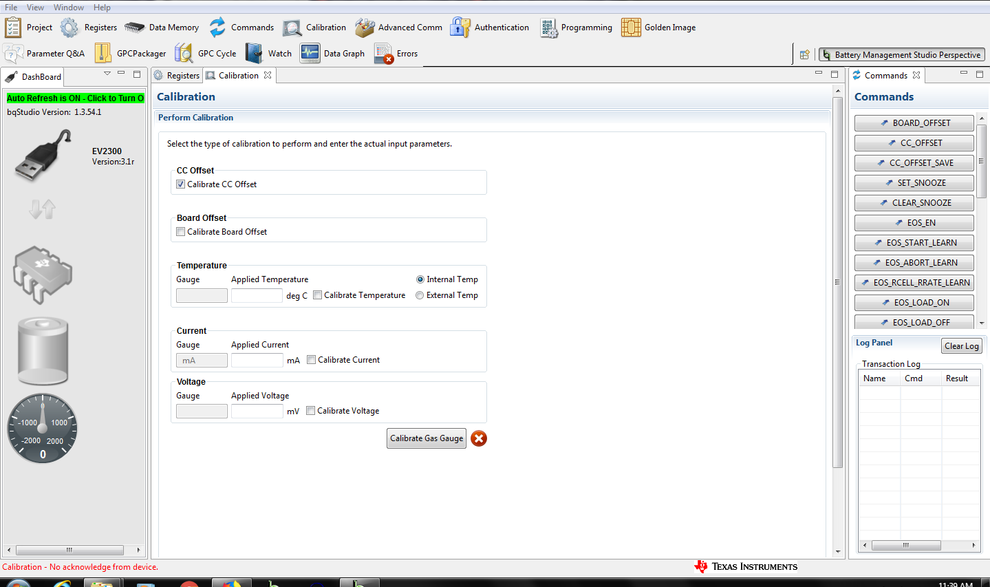

    By changing the IC, I am able to communicate with processor.
    I have started calibration according Chapter 5 of the bq34110 Technical Reference Manual. i am using 12 V battery for my device. Can you help with me which parameter need to update in data flash memory ?
    it will be great if can share any example file for calibration data.
    Viken
  • Hi Viken,
    How are your jumpers set on your EVM for the voltage divider to the BAT pin (J2 and J5)? For a 12V battery, it is important to set the J2 jumpers to the >5V setting.
    The 16V setting on J5 results in a resistor divider of around 1/19. Try setting your Voltage Divider in the Flash settings at around 19200mV as a starting point for calibration. You will also want to change the 'Flash Update OK Voltage' Flash parameter in Data Flash (under Configuration) to a lower voltage (voltage must be lower than the voltage on the BAT pin) to allow writing to flash. This can be modified while the device is in calibration mode by using the CAL_TOGGLE command in the right hand side Command window.
