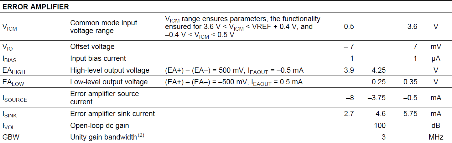

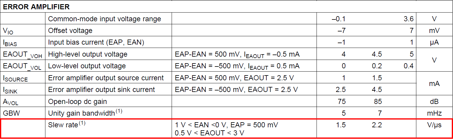

For the UCC3895 error amplifier spec. What does Error Amp slew rate means? What kind of parameter will be limited by this parameters?
For the UCC28950 that datasheet doesn't define it. Does it means no limitation when the EA out has fast △V transient?

  • Hello Ray
    The error amplifier slew rate is the speed at which it can change its output voltage. This rate is 2.2V per us on the UCC3895. It is related to bandwidth so a device with a higher unity gain bandwidth could normally be expected to have a higher slew rate than one with a lower unity gain bandwidth.
    In reality a power supply control loop will be closed at a frequency much lower than the unity gain bandwidth - 10kHz is typical and at these low frequencies the ability of the error amplifier to change its output voltage will not be limited by the slew rate. This is the reason why the slew rate is not given in the UCC28950 data sheet.
    I hope this answers your question - if not then please let me know.
