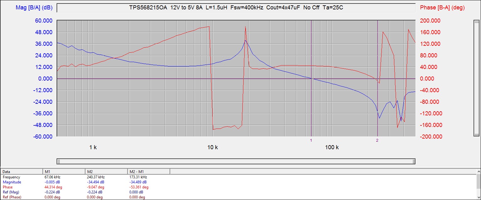

TPS568215EVM User's Guide has Loop Characteristics graph on P.8 Fig 7.
Please let me know the measurement condition.
I would like to know the injection resistor value (R6) , injection swing level and measurement equipment.

We don't have the exact measurement condition about Fig 7 becasue it's measured during device development and not measured by us.
Here I attached another bode plot for your reference:
Equipment: AP300;
Setup: TPS568215EVM with described test conditions;
AC injection: fs<1kHz---300mV; 1k-10kHz----linear decreased from 300mV to 30mV; fs>10kHz 30mV
R6=20 Ohm
Vincent-san,
Thank you for your reply.
Is drop of phase curve at about 10kHz to 20kHz is due to insufficiency of injection amplitude level?
Kohei Sasaki
Sasaki-san,
Drop in phase is because it exceed 180 degree so the software subtract it to -180 degree automatically.
