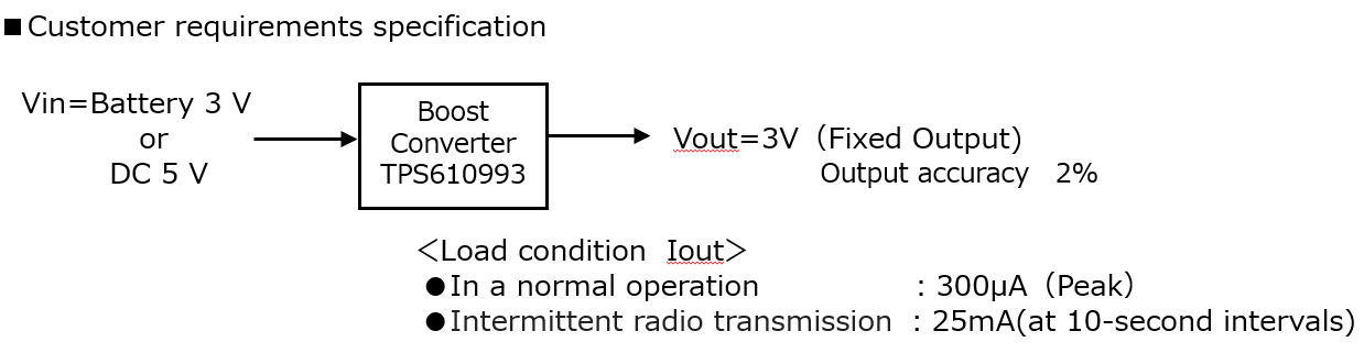

We have a question about efficiency when VIN> Vout of TPS 610993 from our customer.
■Question
What is the efficiency when Vin = 3 to 5 V, Iout = 300 μA or 25 mA?
(During down mode or pass-through operation)
Seishin

Dear Jasper Li,
Thank you for the quick reply.
We confirmed with the customer that output of Vin level at Vin> Vout + 0.5 V is unacceptable.
Since TPS61099x does not meet the required specifications, we would like to propose a different device.
