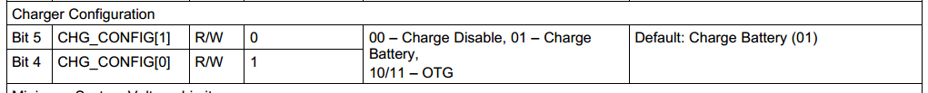

when OTG pin is high, and REG01[5:4] = 01B/10B, in boost mode.
but when i set REG01[5:4] = 00B, there is still a 5V on pmid pin.

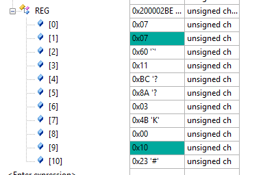

    When I set REG01[5:4] = 00B, read back the value of REG01[5:4] is 00B, all resiger values are as follows:
    when i set it 01B, the value is 01B. so, it is expected value.

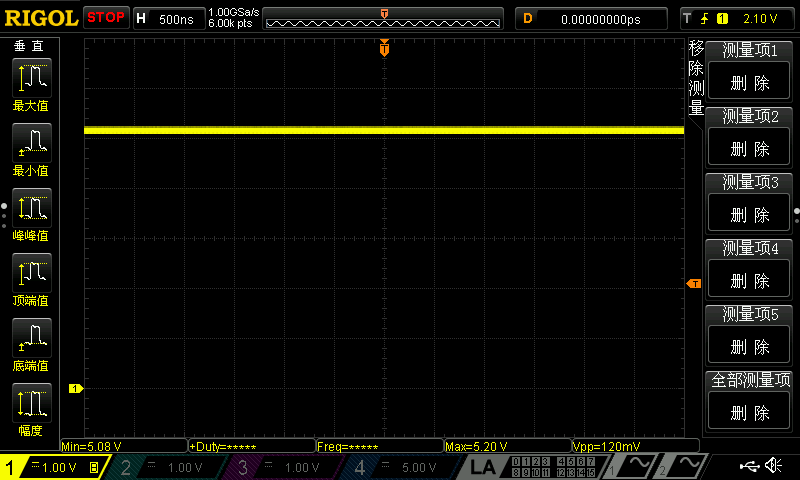

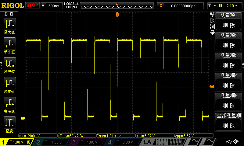

    I still check the waveform of SW node:
    and PMID pin:

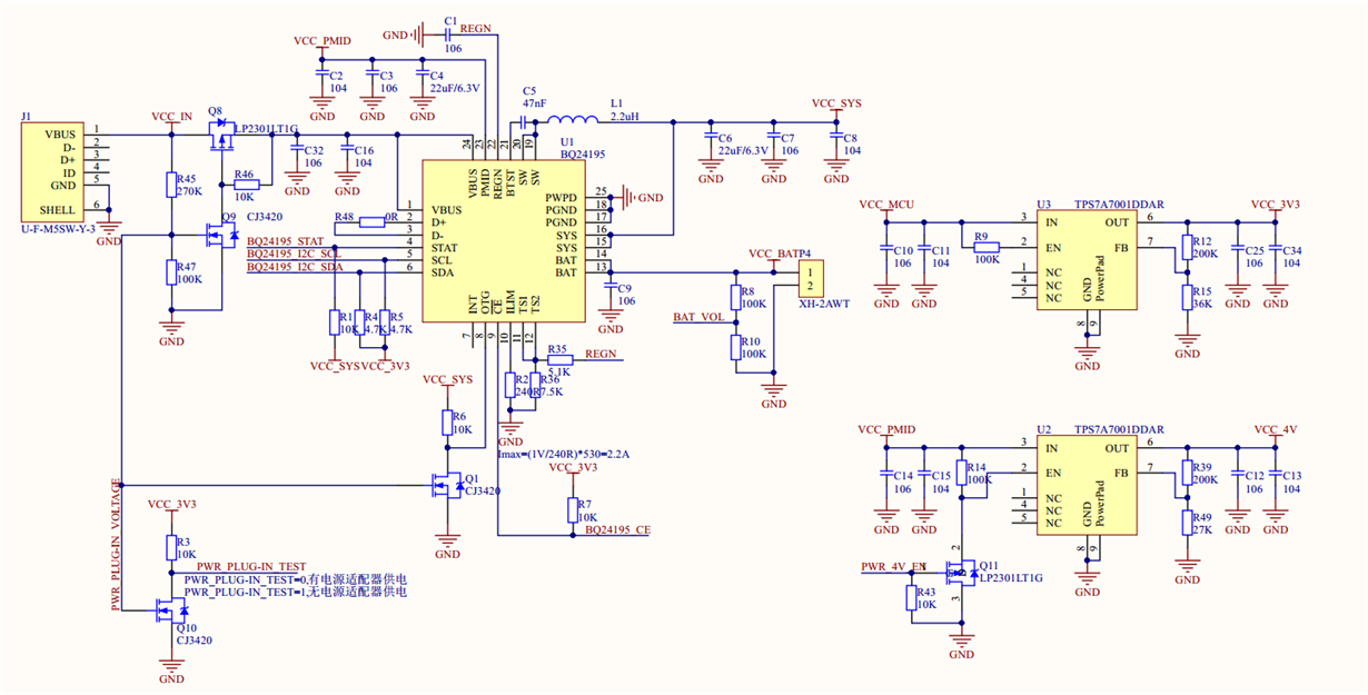

    the schematic:
    The PMID is about 5.1V-5.2V, indicating the OTG boots is still in operation. For debugging purpose, can you pull OTG low to find out whether charger can exit the OTG boost mode? Please also try to let the watch dog timer expired so the register can be reset to the default state to exit the OTG boots mode. Do you have a TI EVM to make a comparison test using bqStudio?
