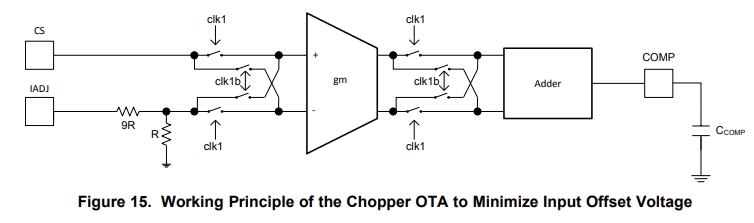

On the datasheet figure 15 shows OTA circuit to minimize the offset voltage.
However there is no detail how this circuit works. Could you give me some more detail?
Koji Hamamoto

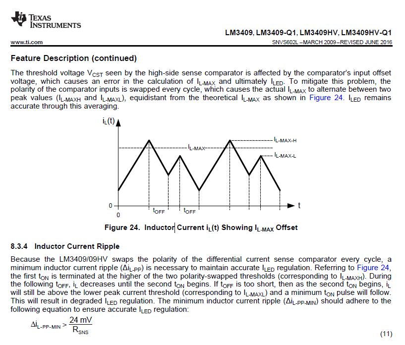

    If you use a comparator to detect a trip threshold the input offset for the + and - terminals can be compensated for by alternating swapping the inputs and output.  As an example only, if there is a 1 mV error on the input offset the alternating measurement of this offset will be +1mV, -1mV.  This averages to zero removing the input offset as a portion of the regulation error.  this will make the current ripple have a small component of alternating ripple levels:
    The LM3409 has a better description of this, datasheet page 11, it regulates peak current but the alternating measurement has the same affect:
