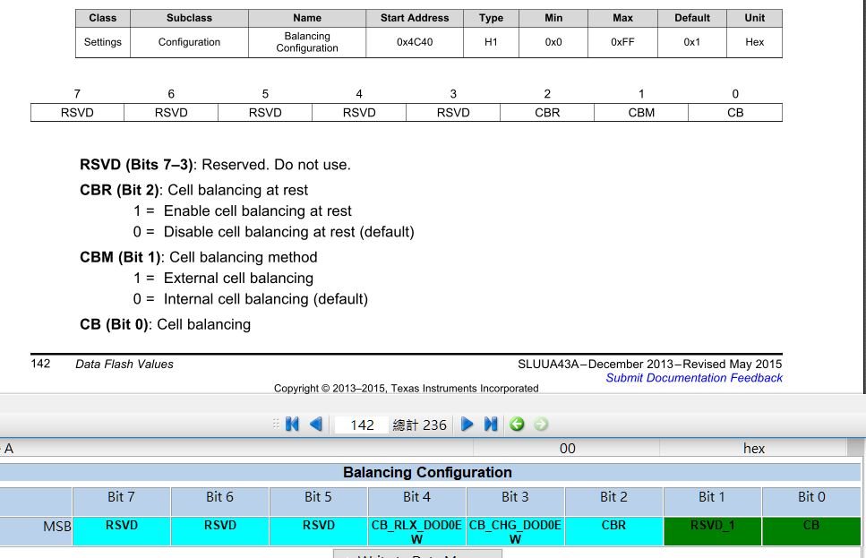

BQ40Z60: Register not referenced in the Technical Reference Manual
Part Number: BQ40Z60
Other Parts Discussed in Thread: BQ40Z50
HI, Onyx: I encountered the same problem above and I often try to find the answer in the BQ40Z50 file, but I still can't explain it. TI should update the Technical Reference Manual corresponding to the current F/W version.
Can we get new documents?
