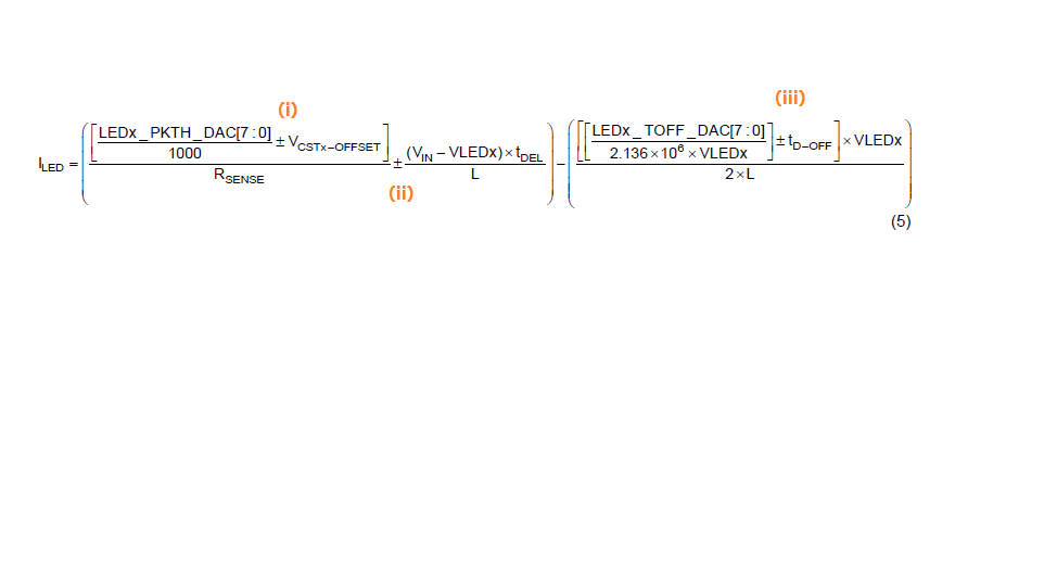

Equation (5) on data sheet can be used to estimate output accuacy of average LED current. ( excluding Rsense and L(uH) )
Anyway, there are three +/- on equation (5). ... please kindly refer attached.
Max: (+), (+), (-) Min: (-),(-), (+)
Is it correct? Please confirm.

  • Hello Kanji,
    1) Yes that switching frequency range is fine. You can PWM dim at 1 KHz or 2KHz it just depends on how accurate you want the dimming to be. If the LED current ripple is fairly low it's not as critical. If you want it to be more accurate at 0.1% a lower PWM frequency will be better. "Also, what value " n " is recommended PWMx frequency versus Fsw;siwithing frequency = 1: n?" This depends on what is acceptable operating for you. Sometimes trying different PWM frequencies and dutycycles and observing is the best was to see if it is acceptable.
    2) That looks correct.
