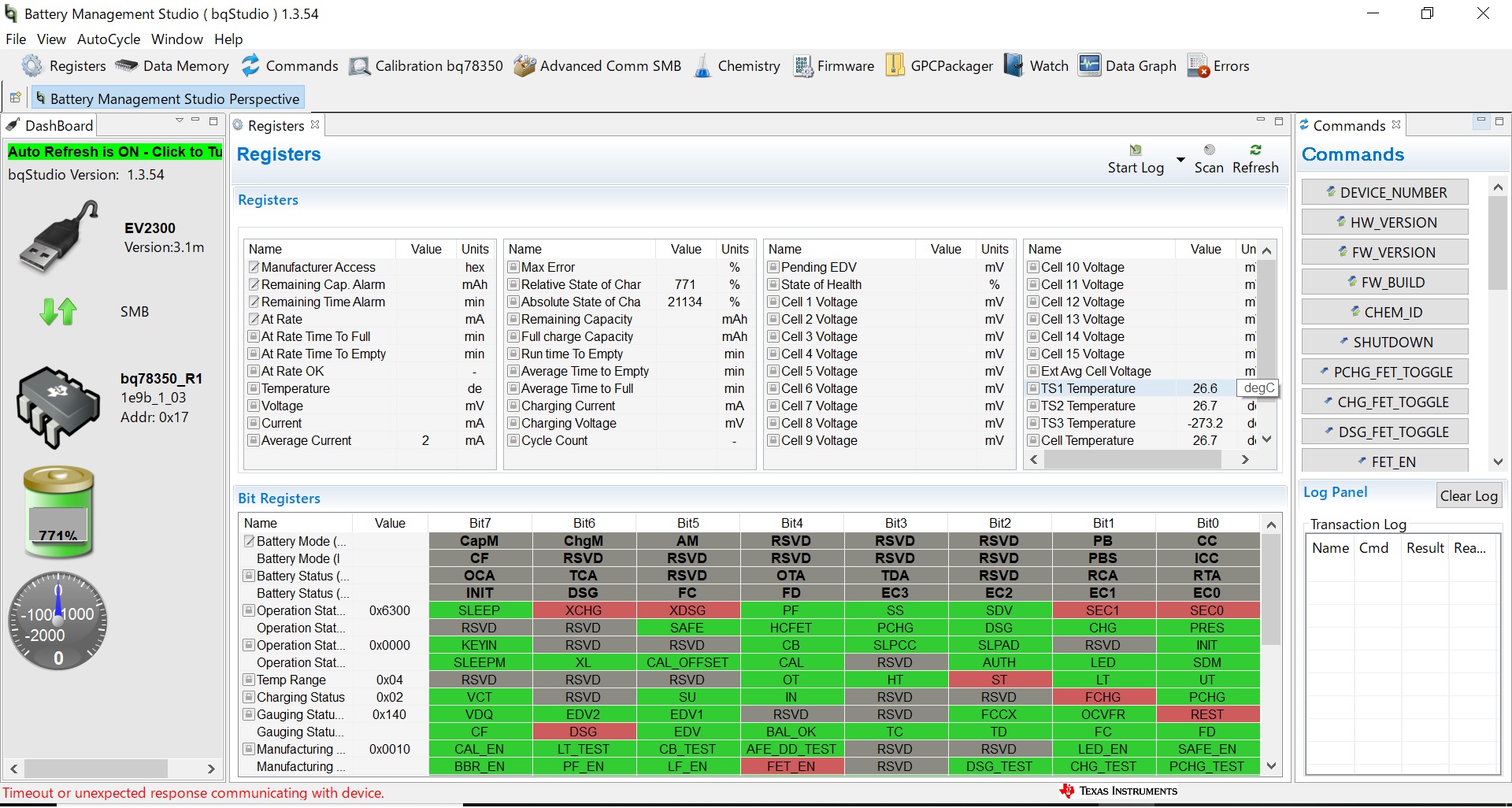

1. SMBus communication error means RSOC shows 771% and other command codes can't recieve.
 ※see attached image1
2. The failure IC can overwrite FW by BQSTUDIO.

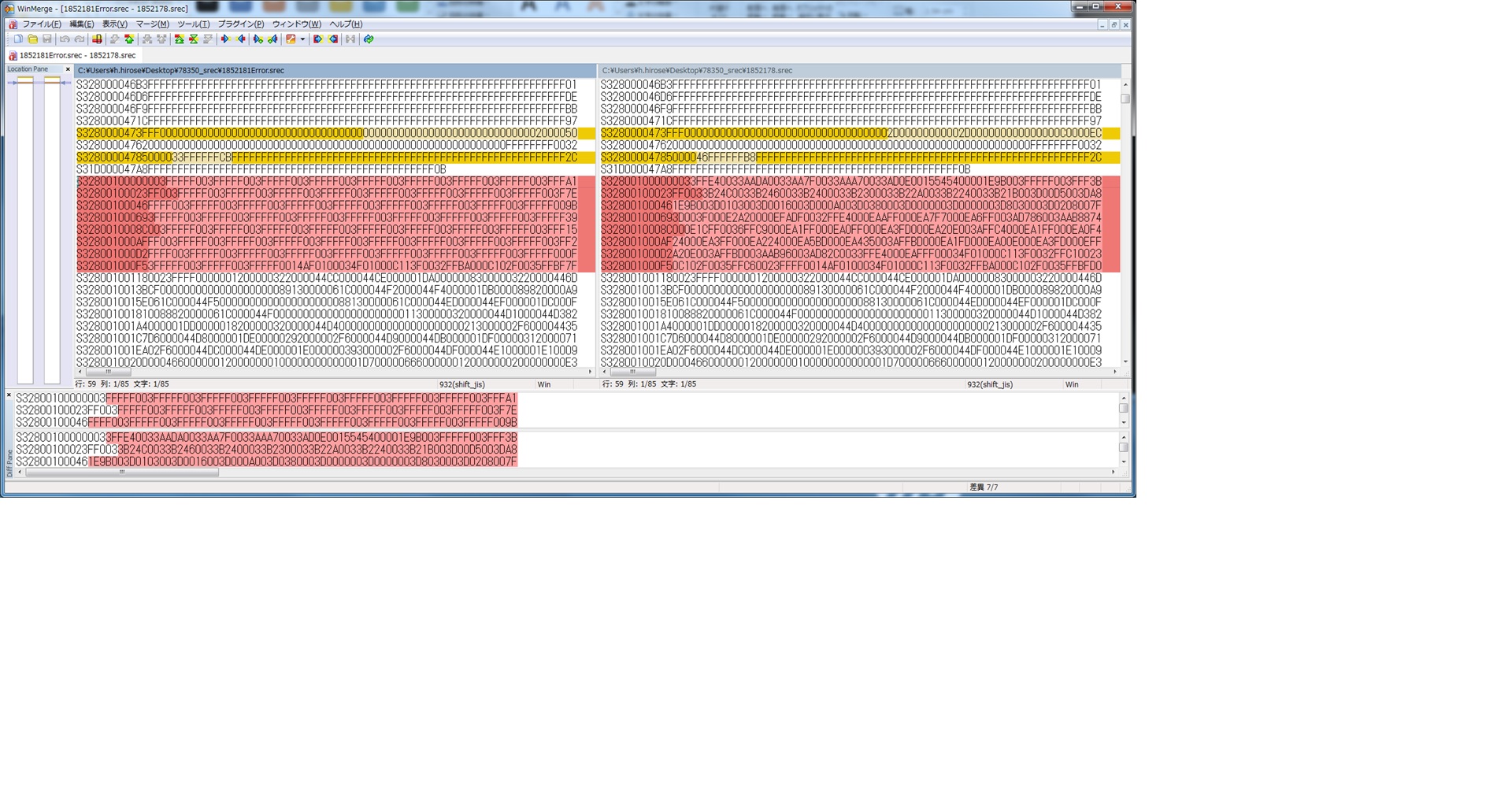

4. to import srec from failure IC and compare with srec which is before break, 256 byte data seems to be changed to erased state(0xFF).
  ※see attached image2, left:failure right:normal

image1: registers value

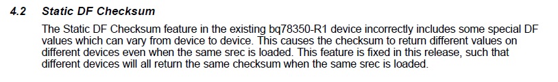

    In the sluubd3c, following article was confirmed. Is there any relationship to this failure?

    The "Error" file pictured above shows part of the flash erased. That would not be from a check sum calculation. Most likely the -R2 is loading the supply differently as the part shuts down. If you believe the part is bad please return a few pieces through the supply channel.
    noted.
