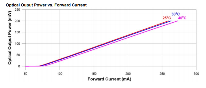

My diode laser has a operating Current of 200 mA and threshold current 70 mA.
Thus,  I increase the value of voltage in "DC Input supply" until obtaining 200 mA and also increase the value of voltage in "DC bias supply" until obtaining 70 mA in the evaluation module, is the procedure correct?

    Could you please let me know what threshold current means?
    1. You are right. You will get 10 ns pulse with 1 us period.
    2. The DC bias voltage is always fixed. This will supply the 5V to the LMG1020 IC. To have the laser diode fired up with the current you desire, you can just increase DC input supply. This increase on the voltage will increase the di/dt on your laser diode and finally help to achieve the current you need.
    Lixing
  • Hi Lixing,
    Thanks you for your answer.
    The threshold current is the minimum current needed to sustain Laser action in a Diode laser. My diode laser is 70 mA.
    Mónica
  • Hi Monica,
    No problem. Thanks for letting me know. This current is only related to the behavior of your laser diode, but does not affect the circuit operation as what I have explained above. Please let me know if you still have any questions. Good luck to your design.
