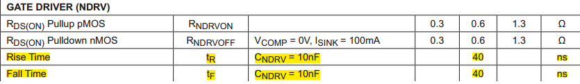

4. 692 output spurce / sink capability of DRV pin? below is MAX20090 spec.
5. Could you commend for TPS92692 better than MAX20090?

    4) Gate pulling high is 5.4 ohm typical, gate pulling low is 4.3 ohm typical.
     So, MX20090 looks source/sink capability strong than TPS92692. Could you help us to provide math about pulling high/low ohm transfer to Ampere?

    4) This depends on the MOSFET you are using and how much current you are trying to regulate. Basically for turn on the current during the switching transition is (Vgate high - Vgatethreshold)/Ron and the turn off current would be Vgatethreshold/Roff.
    Example, Vgatethreshold at 4V, Iongate would be (7.5V-4V)/5.4 ohm = 650 mA, Ioffgate would be 4V/4.3 ohm = 930 mA.
