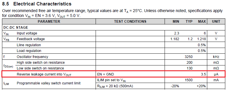

Hi Team,
Could you tell me the condition of VOUT voltage about "Reverse leakage current into VOUT"?
Is 5V applied to VOUT pin externally?
