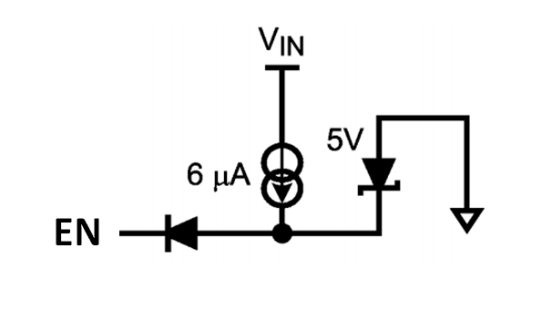

  • Hello David,
    The EN pin has internal clamp at 5V and a diode in series, so the pull-up voltage on the pin is actually less than 5V.
    Here is a diagram:
    You can also try a level shifter,similar to the one on your other post.
    Here is an example:

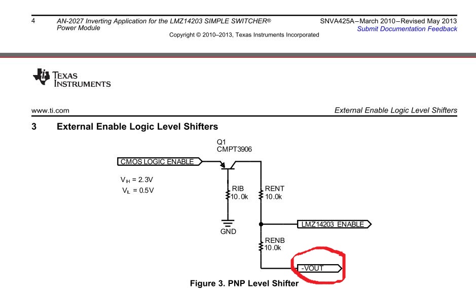

    I have built a circuit as the PNP 3906 transistor for test but can you please confirm or explain this point
    Why the circuit is connected to the negative V out as this case is a negative generator , that do not look as normal if that a shifter normally the Volt source is positive as the En pin request a positive Voltage
    David
  • Hi David,
    The application note above is actually for enabling the LMZ1420x when it is in inverting configuration. The -VOUT rail in that case is the return(GND) pin of the device.

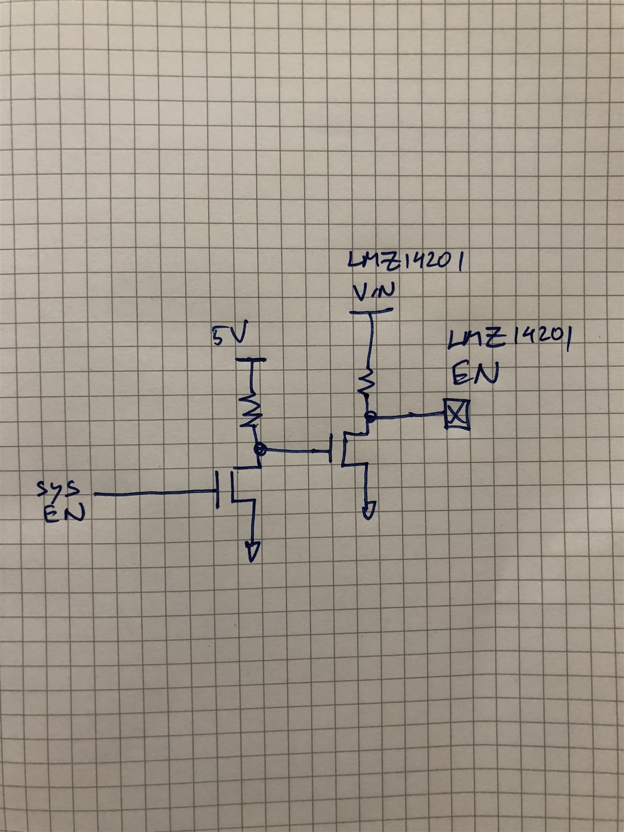

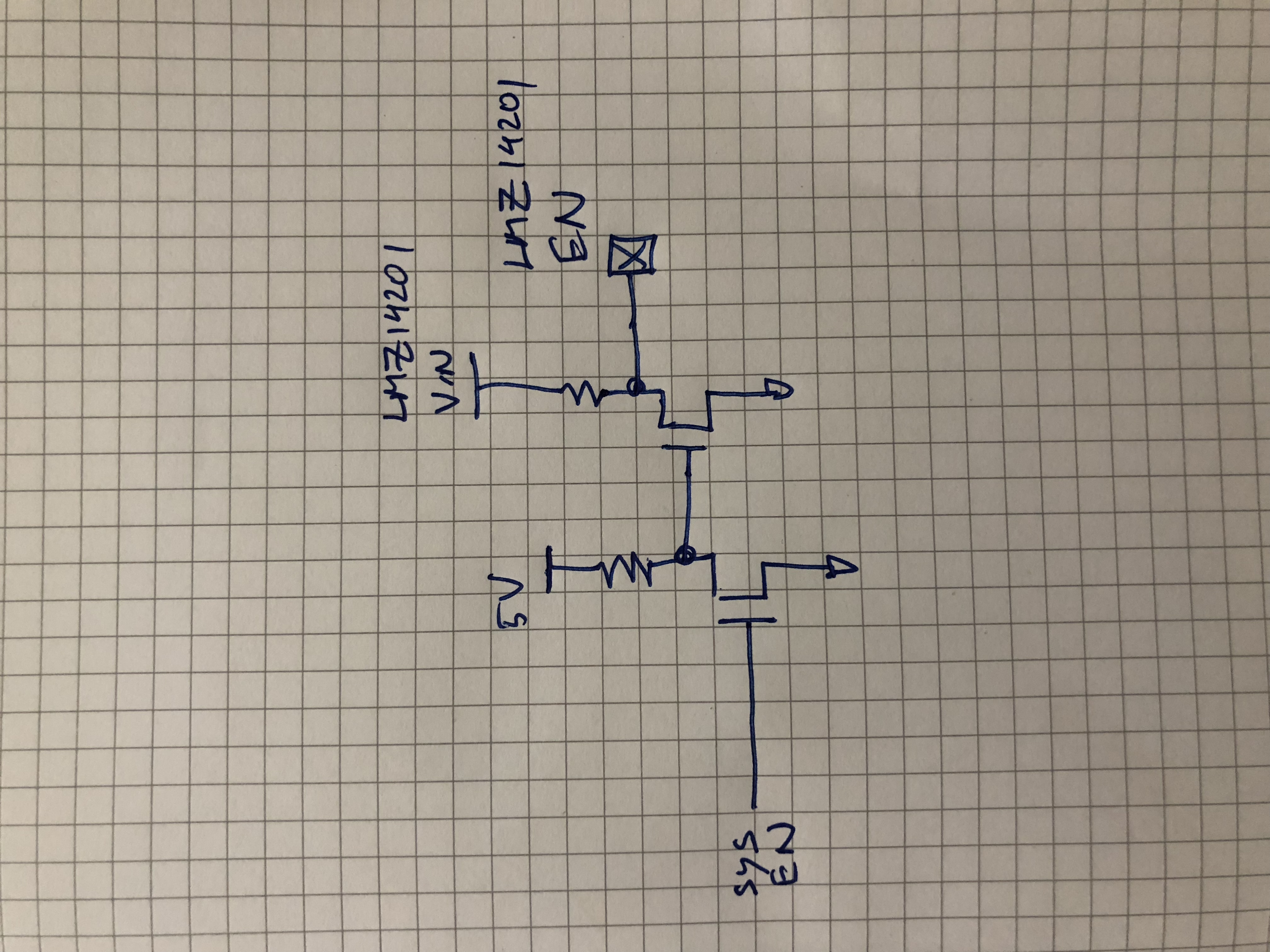

    In your case perhaps you just need something like this:
    SYS_EN would be your logic signal driving a small N-ch MOSFET.
    Let me know if this helps.

  • Hello, Denislav
    thanks for the Mosfet circuit
    one question : as the EN pin is floating but with a voltage due to internal conception of the LMZ , does that safe to ground it straight without a resistor ? when the TTL / Flag command is off
    so shall I add  a P channel to put the EN pin to the ground through a resistor when EN is OFF ?

  • Hi David,
    It should be OK to ground it without a resistor. The internal pull up current source is only 6uA.
    If you want to place a resistor, you can, but it will add another component.
