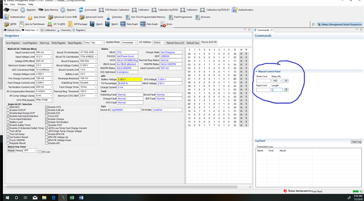

I'm totally new to this, and I appreciate any helps.
Task: reading battery voltage and system voltage and set watchdog timer to disable.
How:
Reading battery voltage: Read REG0E bit 6-0
Reading system voltage: Read REG0F bit 6-0
Set watchdog timer to disable: Write to REG07 bit 7-0 the value 1000 1101
Question:
How can I send command to accomplish those tasks? You guys can point me to a resource that you use to learn those skills as well if you want.
