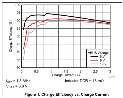

  • Suppose the current INPUT POWER is 5V/500mA. According to the calculation method you provided, it is about 5*0.5*0.93=2.325W, but I want to know the voltage of Vsys, not the power.
  • Hi Allan:
    You want to know the VSYS voltage instead of VSYS power, correct? When battery is not present, there are 2 cases:
    (1) If charge is disabled (by CE pin), VSYS=3.68V
    (2) If charge is enabled (by CE pin), the system voltage will oscillate between charge and recharge voltage. That's because BAT pin voltage will be charged up and charge is terminated. After VBAT is discharged to recharge level, charger will be enabled. As a result, BAT and VSYS voltage will oscillate between fully charged and recharge voltages.
