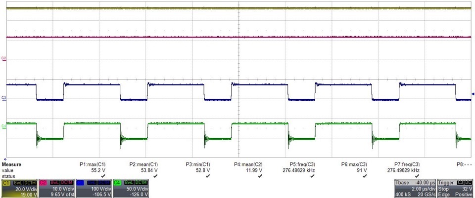

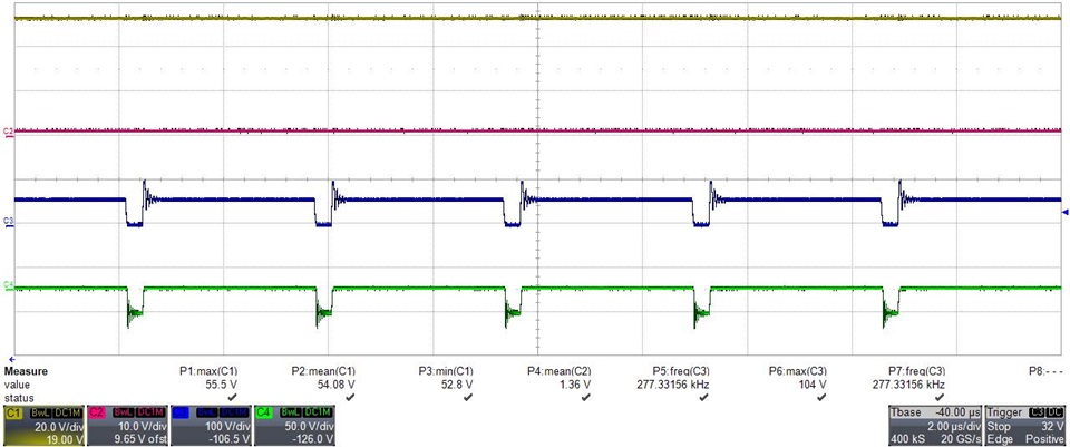

When the TPS23754 for short-circuit detection,
Although the IC turns off, without output voltage, but still have output current,
and PWM is still oscillating, the PWM frequency has not changed.
Only the Duty H/L ratio is changed.
PR9(Rcs)=0.13,Io=5.xA,Vo=2V
PR9(Rcs)=0.26,Io=4A,Vo=0.09V
I would like to ask:
1. How can i modify, there will without output voltage and current when short-circuit.
2. What is the mechanism of PWM when short circuited? Change the Duty H/L ratio? Change the PWM frequency?
3. What is the CS calculation formula?
