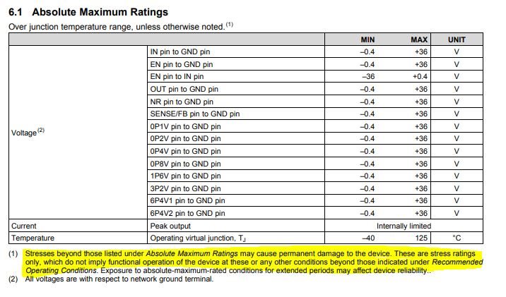

  • Hi Ryan-san,
    I found that the AbsMax for OUT, NR and SENSE/FB pins is definitely mentioned in TPS7A47-Q1 data sheet as below, so would this mention be also applied to TPS7A47(the non-Q1 part) ?
    If yes, not only our customer but also I believe that TPS7A47 data sheet should be revised.
    Could you please tell me your opinion about it ?
    Kato
  • Hi Kato-san,
    You are correct that it has become best practice to state the Absolute Maximum voltage rating for Vout on LDOs without a dedicated reverse current protection with reference to Vin. I have noted for this to occur in the next datasheet revision for TPS7A47.
    Very Respectfully,
    Ryan
