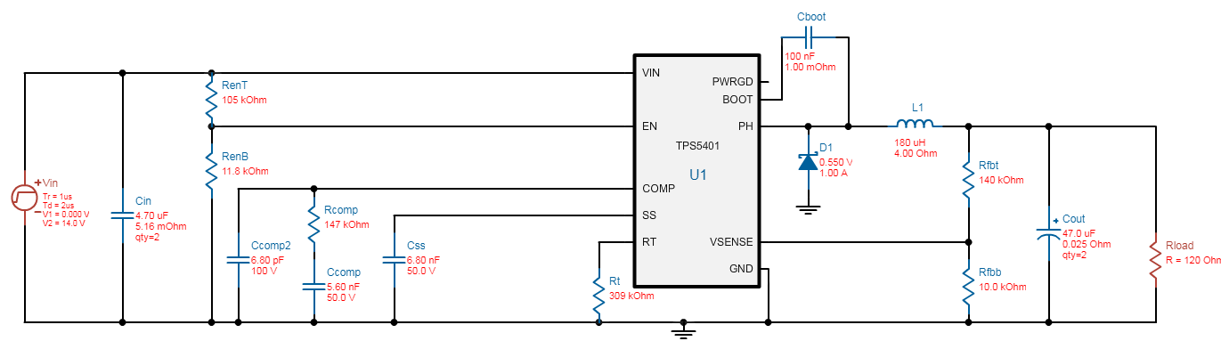

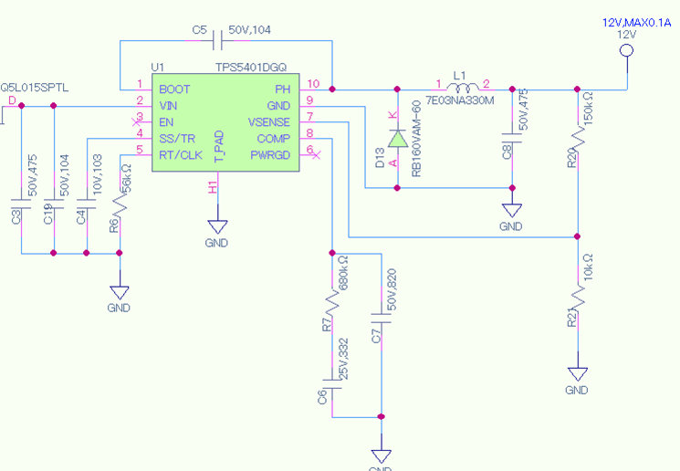

Vout=12V and Iload=0.05A are assumed.
In customer design, when VIN is decreased around 15 V, output starts to lower than 12 V.
What do you think the cause of decreasing output level with decreasing input?
BestRegards
Please use the lower Switching frequency operation to extend the off time for the Boot charge referesh . Use 400KHz switching frequency instead of 2MHz .
The Feedback resistor is designed wrongly . Use 140K and 10K for the feedback to get 12V output .
Please follow the shared schematic of the design
