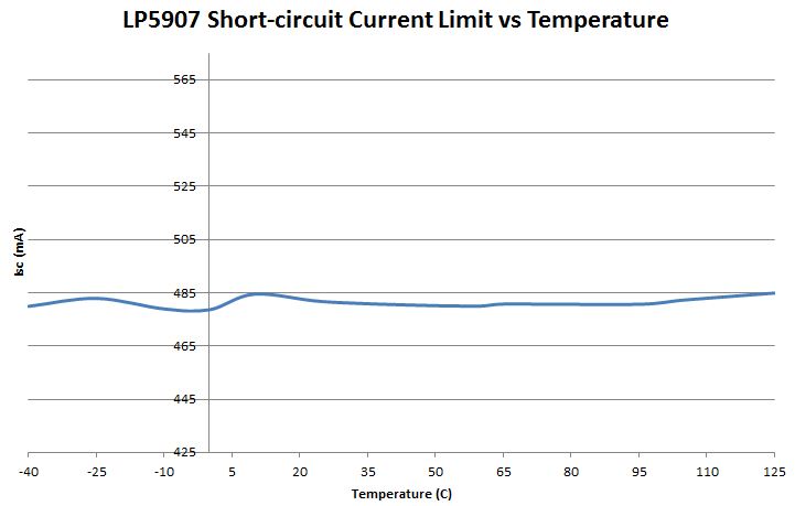

LP5907: Do you have any graph of typical data of Short-circuit current limit(Isc) vesus ambient temperature?
Part Number: LP5907
 Hello guys,
 One of our customers is considering using LP5907. They want to have any graph of typical data of Short-circuit current limit(Isc) vesus ambient temperature?
 Do you have the graph?
 Your reply would be appriciated.
 Kazuya Nakai.
