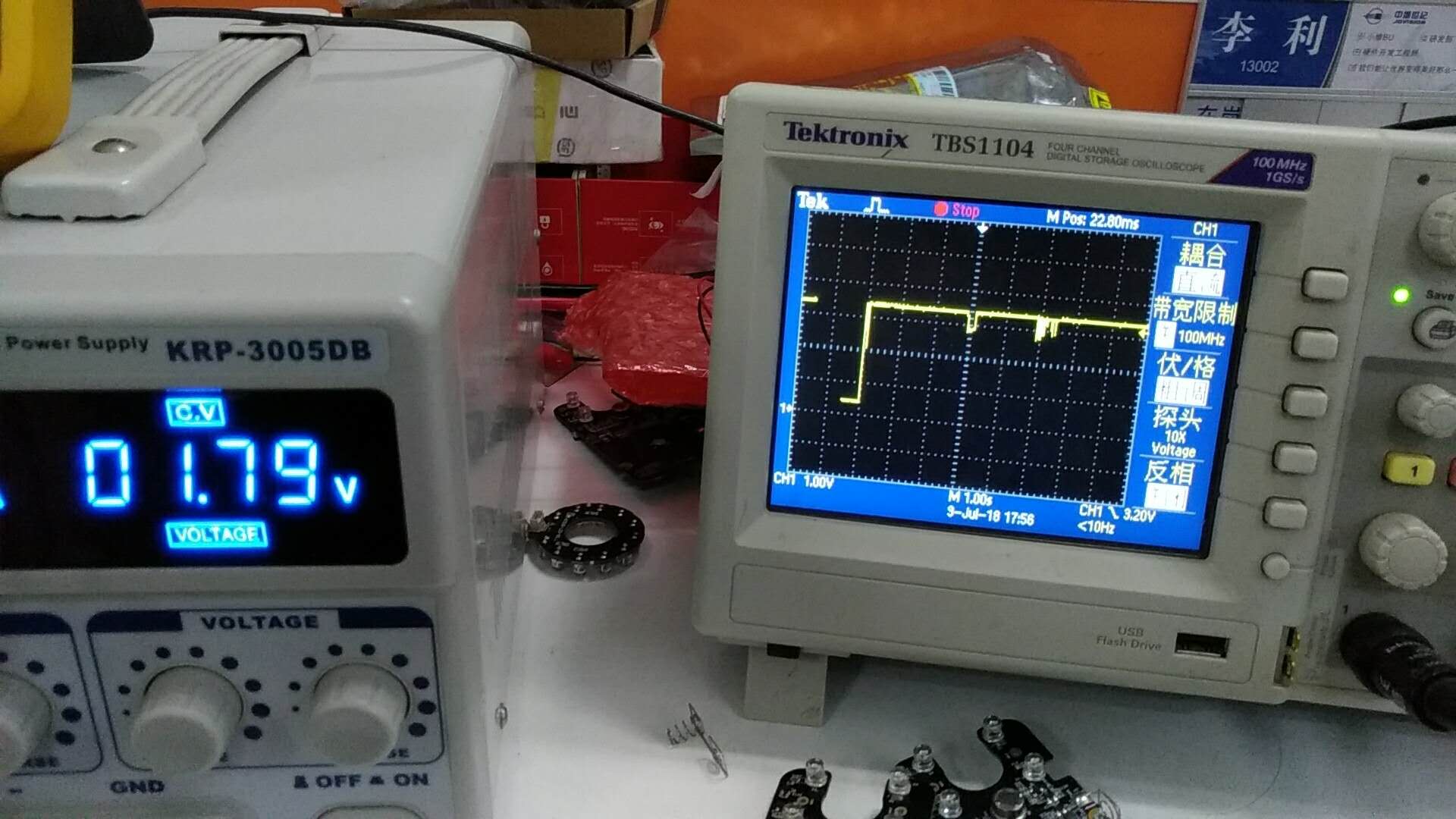

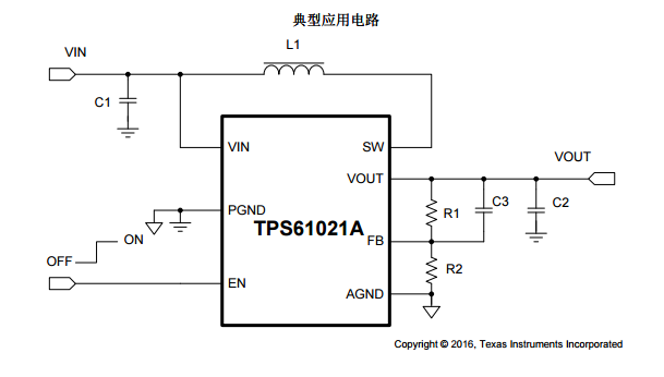

        Now I get  some  TPS61021A  sample,because I do not have much time to make a PCB, I use some fly line tie  the IC pad to PCB pad. I used digital power supply 1.8V for TPS61021A, when the load current from 500mA to 1A, the voltage droped and my MCU  restart. please give me some suggest for this case,thanks.L1 is 1Uh/2A,R1 is 240K 1%,R2 is 75K 1%,C3 is 47pF,C2 is10uF.
  • Hello Chen,
    The layout of a boost converter is critical for normal operation of a boost converter. We can see unexpected behavior if the layout is not good. So I would suggest you do a real PCB or apply an EVM for evaluation.
