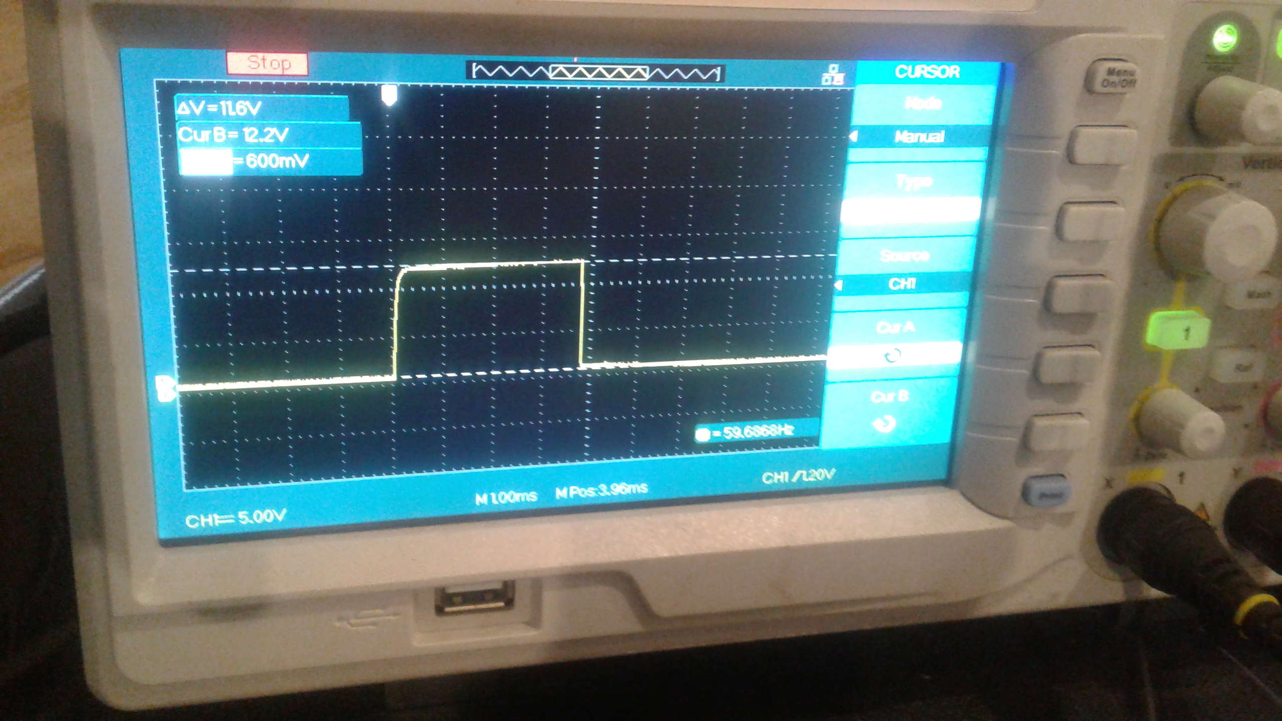

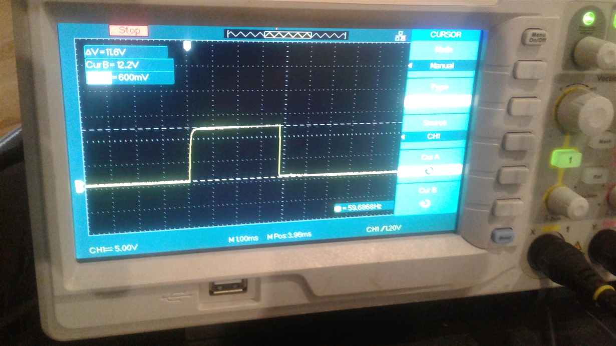

    Now I am able to get discharge voltages at discharge pin of AFE of 11volts. But after 4ms voltage is becoming zero. Since there is no load connected to SRP-SRN pin or to shunt resistor but discharge pin voltage is becoming zero.

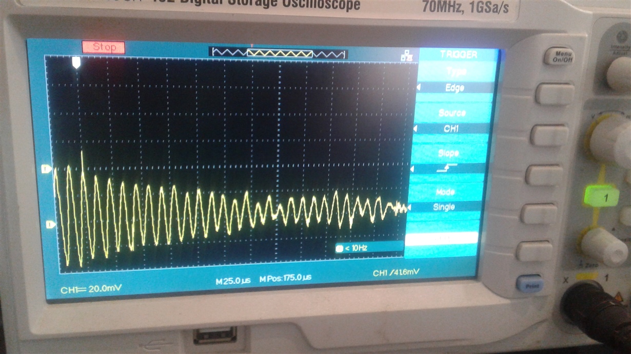

  • hi
    please find below ripples scan and output scan after filter.
    Still after placing filter relatively near to IC, output is going low after 4ms once discharge bit is enable in control register.

    To make current to flow through the shunt resistor, i have to turn on discharge mosfet. for that i need to make discharge pin high. i am able to make volt at dis pin high but it is becoming low after 4 ms. let me check after connecting with battery -ve and +ve with some load.

  • Hi Imran,
    The high frequency mV signal does not look good. The capacitor on the sense input should not be as important as the resistor connections. SRN and SRP should look like GND.
    After DSG goes low read the status register to see what fault was registered.
