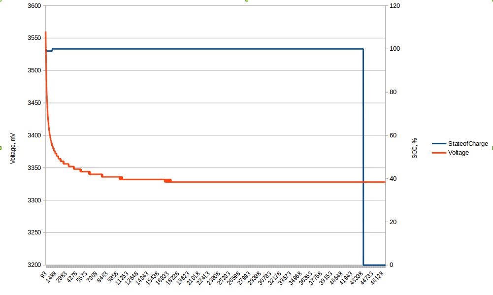

  • Hello Matt,
    Thanks for your assistance on this issue. This is what I expected as well, but reviewing 20180703afterfirstchg.log in the attached zip file, I can see that voltage reaches at 3328 mV at DateTime=2018-07-04 10:45:08 and ElapsedTime=68464.328, and remains at that value until SOC is is reset to zero. It appears the dV/dt condition may have even been reached earlier than this time depending on the window used for the calculation, and I see no evidence of noise issues on the voltage sensor. Here is a graph of Voltage, with SOC plotted on the secondary, to show when it drops to 0.
    Any thoughts on where to look next?
    Justin

  • Hi Justin,
    I have a few suggestions to debug the issue you are seeing.
    First, can you tell me the ChemID that you selected? We need to make sure it is the right match for the battery you are using. This may or may not be related to the issue, but it is very important for the Impedance Track algorithm to achieve a successful learning cycle.
    I think the charge method may be part of the problem. Right now, you have FC Set = 100. This means the FC bit will be set when the charge voltage reaches the specified voltage. However, for LiFePO4 batteries, the battery is not yet fully charged at this point (it might be around 60% full). Instead of shutting off the charger, charging should shift to constant voltage mode to complete the charge. It may help to change FC Set to '-1'. This will set FC based on multiple conditions including the taper current.
    If this resolves the issue, there are a couple more things to keep in mind to achieve a successful learning cycle. LiFePO4 cells do take longer to settle, so the relax time after charging may take around 48 hours. When the DOD values start to update, you will want to see at least 90% of the range covered for a good learning cycle. So before discharging, you will want to see a DOD value of less than 10% of the max possible value before you start the discharge in order to be able to cover 90% of the value range.
    Regarding bq40z50-R2, I do think this is a better device to meet your needs. It is based on our latest hardware and firmware platform, so it has improved accuracy and gauging algorithms. This device has superior features and ease of use. The bq34z100 makes sense if you need higher than 4 cells in series, if you need a system side gauge, or if you must support another non-Li chemistry (PbA, NiMH, NiCd).
    Matt
