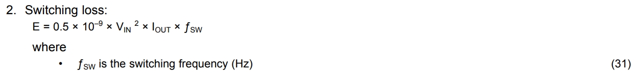

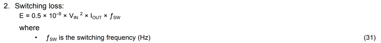

I have a question about the switching loss on the datasheet.
It is shown as bellow,
I think the switching loss is shown "Ploss = 1/2 * Vin * Iout * (Tr+Tf) * Fsw"
"10^-9" may be (Tr+Tf).  I do not understand why "Vin^2" in equation (31) is included.  Is that "Vin"?
